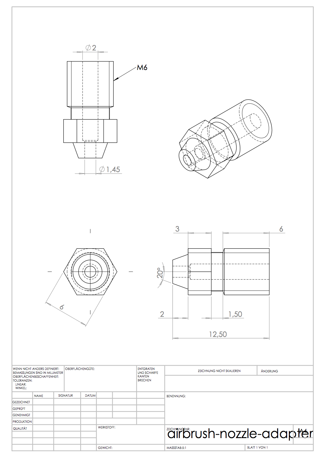

Ordered some custom-made nozzle adapters as I wanted them for my 0.2mm airbrush nozzles… They came out pretty sweet
Now I get a weekend of happy testing!

I assume that those nozzles are made with M1.8 thread, if the tap drill is 1.45mm, am I righ? Your results looks so good that I’m going to try the same thing
