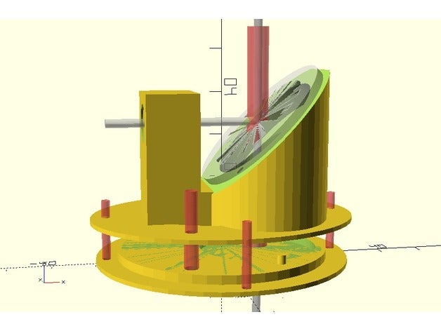

Fantastic. It seems to be rare but mine was also delivered that way. Tested and verified and found everything a-OK. Then there were weeks of mod’ding the house for exhaust, setting up the cooling system and cooling system cooler(drinking water cooler) and then that laser beam combiner hack. Lots of fun to be had.

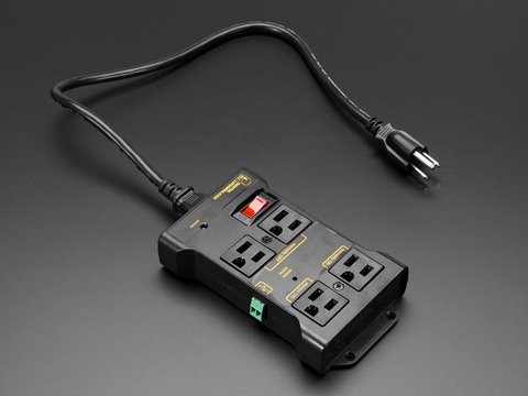

Get one of these:
then wire in your logic board, to the controller, of the receptacle, and plug in you air compression. This will make it so your air compressor only runs when it is needed. Ill get the exact pins to connect in a minute, but my board has a plug right on it for that.
You might also get a receptacle, with USB, and wire it internally. I have done this, to keep all my wires neat.
