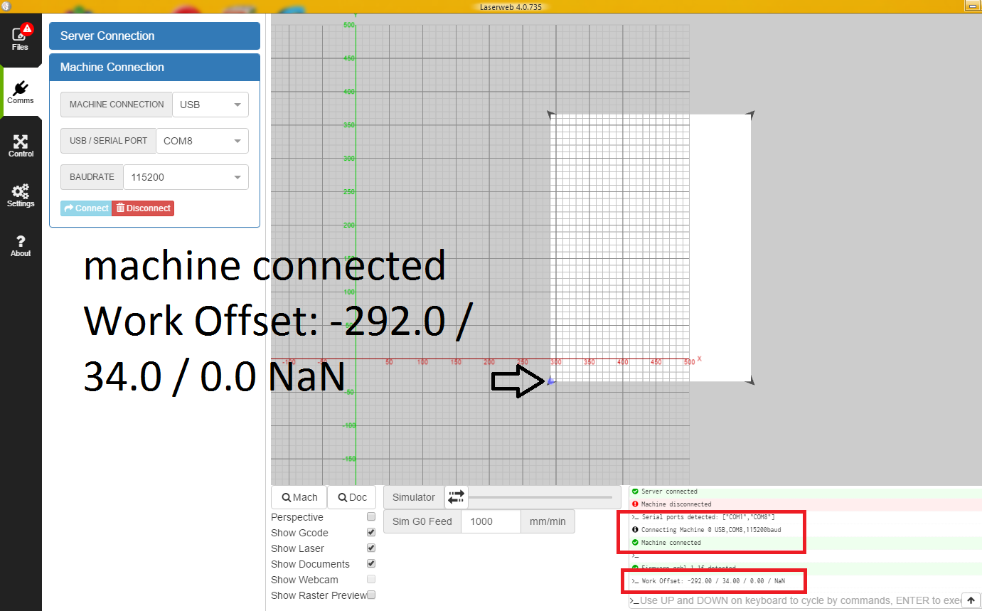

Origin (0,0) automatic moved when LW connect to machine,
Origin (0,0) automatic moved when LW connect to machine, i never set ORIGIN OFFSETS keep it as default X0 Y0. I need to jog manual 0,0 origin every i connect my machine.
If you have homing switches: set Machine Left X, Machine Bottom Y
If you don’t: uncheck Show Machine
@Todd_Fleming i don’t have homing switches, my LW 4.0.735 backend 4.096 i can’t find uncheck Show Machine
It’s out of date. v4.0.735-109 adds the option, but has an issue that causes some SVG files to mess up. Try the update; if it fails to load your SVG files correctly then you’ll have to roll back to the version you’re on now until I fix the SVG issue.
