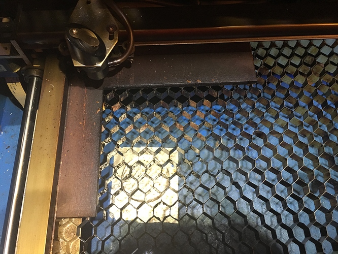

Once my new bed arrives, I want to get a better origin jig set up. Right now, I am using a double layer of cardboard that I cut on the x- and y- axis. That is ok but I want something more permanent. Ned made something like this in the same way.
Would using something like a cut off carpenter’s square or a machinist square work? Ideally, I would like something that has measurements on it. My new bed is honeycomb so I will need to figure out how to secure whatever jig I make to it.

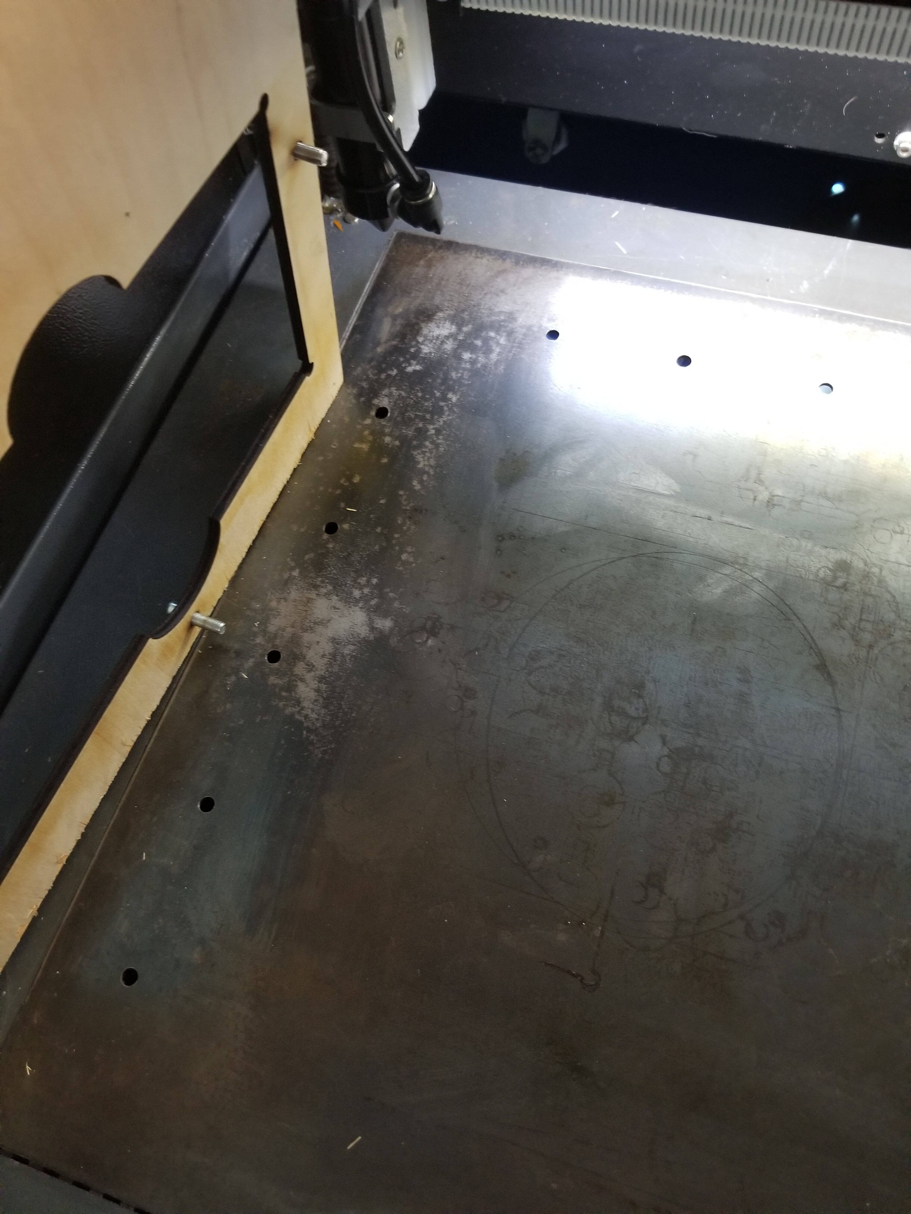

Tossed the honeycomb, replaced with rolled steel.
Holes for alignment jigs, plate with holes, jig at left.
In place

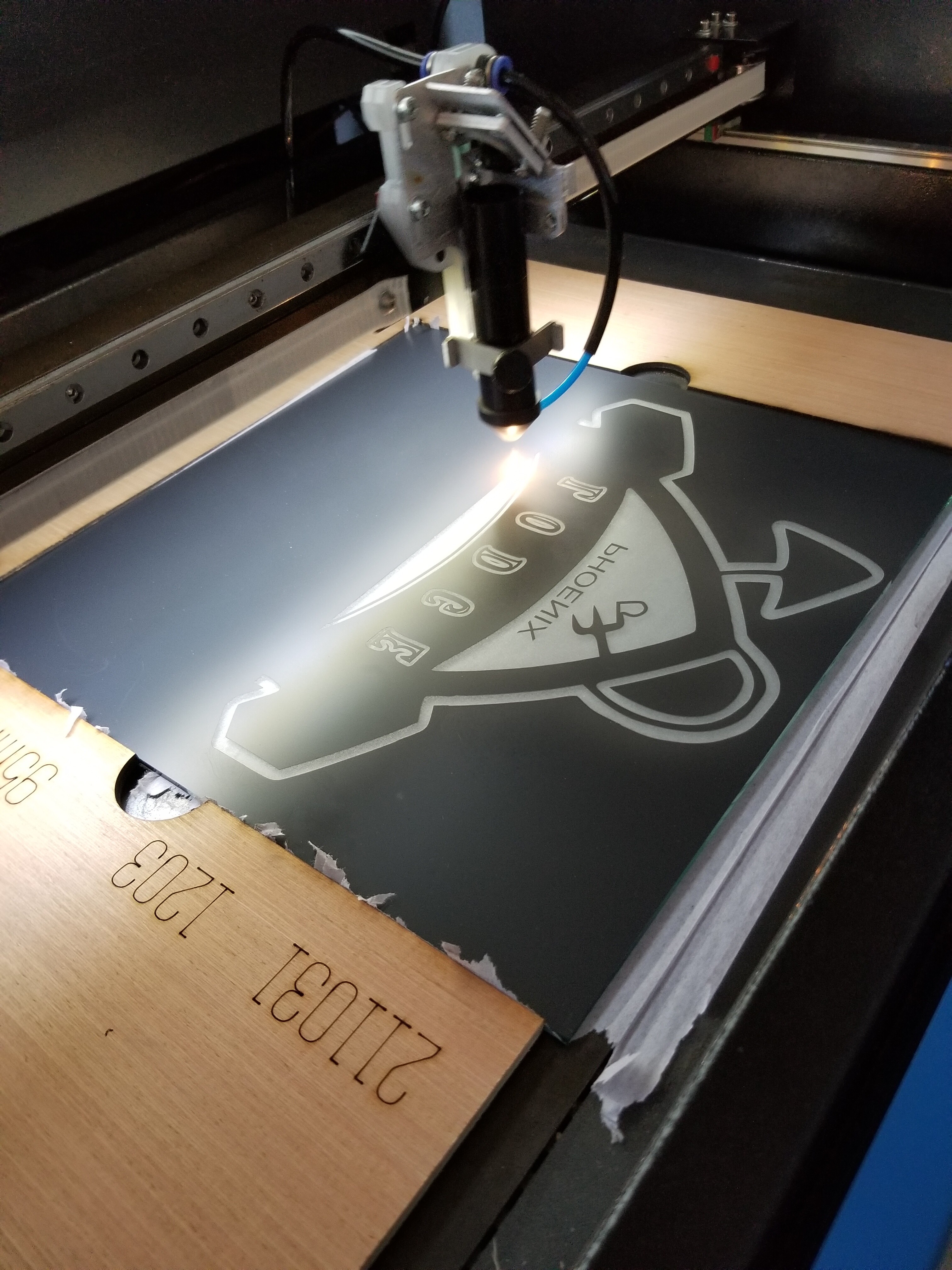

Same game…
:smiley_cat:
Nice jig setup.
Thanks… Here is the same setup. I use it mostly for 12"x12" mirrored tile. Have also used it on slate.
