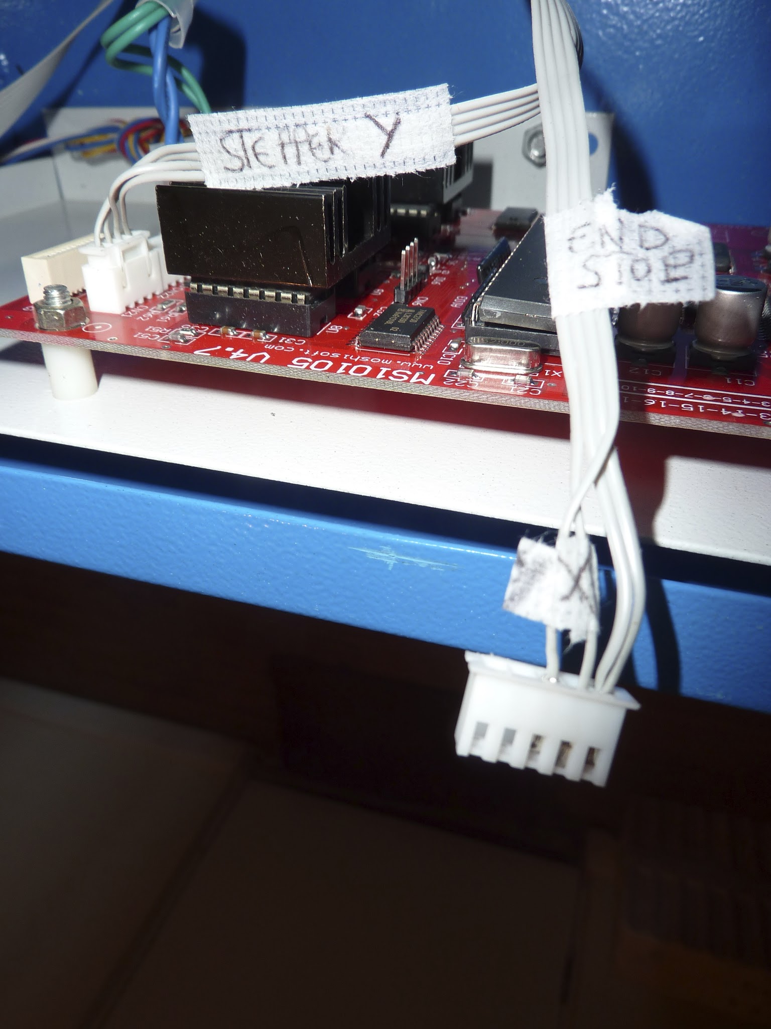

Before dismantling my K40 for Smoothie upgrade, I write down here the original state (stock) for memory and sharing.
Wiring specifications on photos comments.
