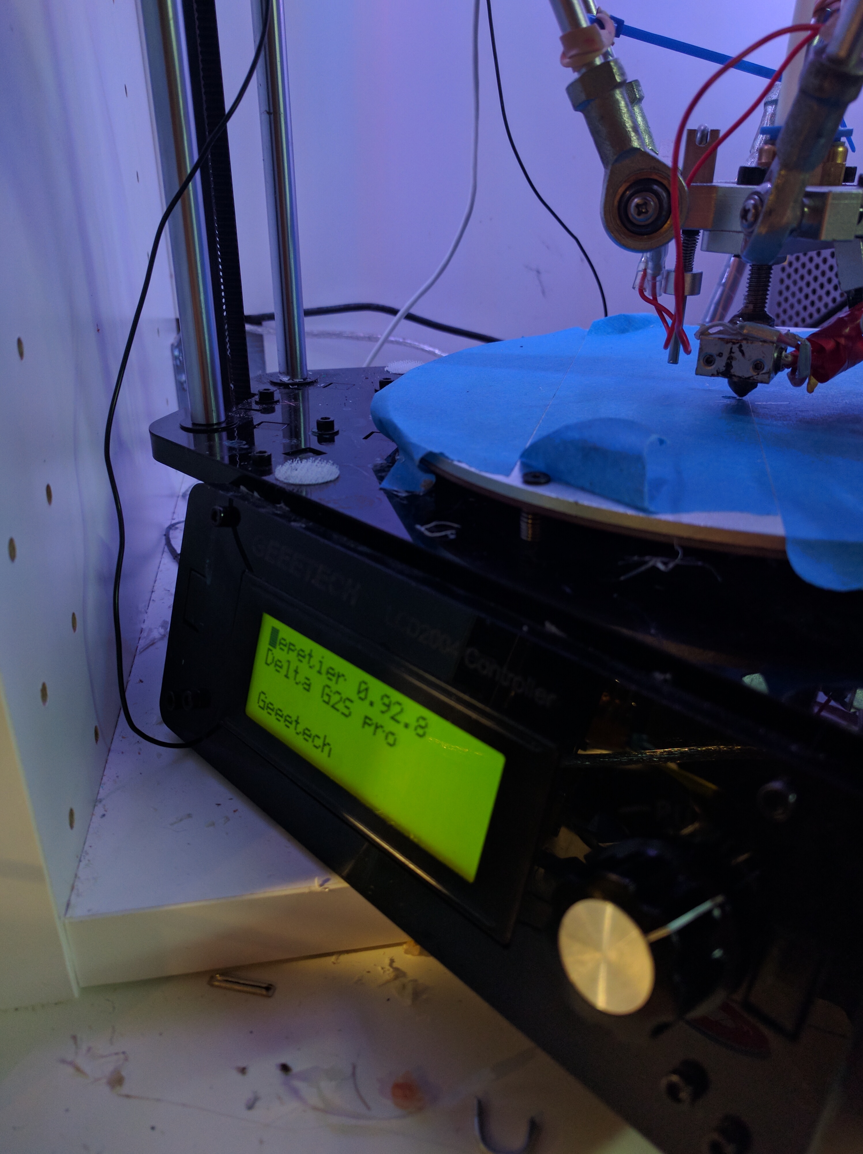

I’ve been running this printer for a while and now it won’t boot past this screen… Tried flashing the firmware again and still nothing. Any idea on how to fix it?
check all of your connections. If it was working then quit, I’d suspect something is loose.
Turned out that the sd card was corrupt somehow. After troubleshooting I pulled it out and it would fully boot up and no longer re boot. Don’t really need the sd anyway as I use repetier server
