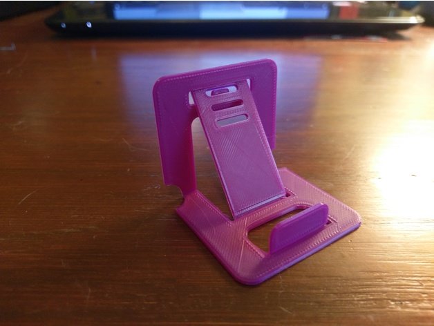

Originally shared by Adafruit Industries Live Hinge Foldable Phone Stand https://blog.adafruit.com/2017/06/01/live-hinge-foldable-phone-stand-3dthursday-3dprinting/ Shared by stalljd2
Live Hinge Foldable Phone Stand #3DThursday #3DPrinting
Shared by stalljd2 on Thingiverse:
Nice little Phone stand that is about credit card size. I did make it in PLA and it worked better than I thought it would. I modeled this after a little phone stand I got a while back, I could find anything like it on the interwebs so I thought hey I’ll just model up a new one and print it instead!!!
Read more: Live Hinge Foldable Phone Stand #3DThursday #3DPrinting « Adafruit Industries – Makers, hackers, artists, designers and engineers!
So initial print is thinner, and it’s clever - I’ll give it that. Personally I’ve made a couple of these: https://www.thingiverse.com/thing:692523
3 interconnected pieces, printed in place - that alone gives it a “you can only do this with a 3D printer” cool factor!
Adjustable and folds down to just a few mm thick. Very handy!
