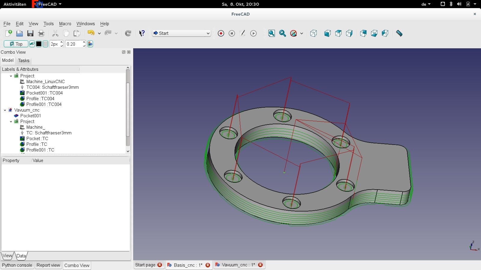

Originally shared by Aglef Kaiser
From FreeCAD to a real part by the help of Chilipeppr, raspberry pi and arduino due with leadshine DM556 driver on my Möderl P2 CNC milling machine. It’s my first part after the preparing the mounting plate. I love the Path workbench. It is still a little raw, but becomes better. On the last pictures you can see the holding tack.
