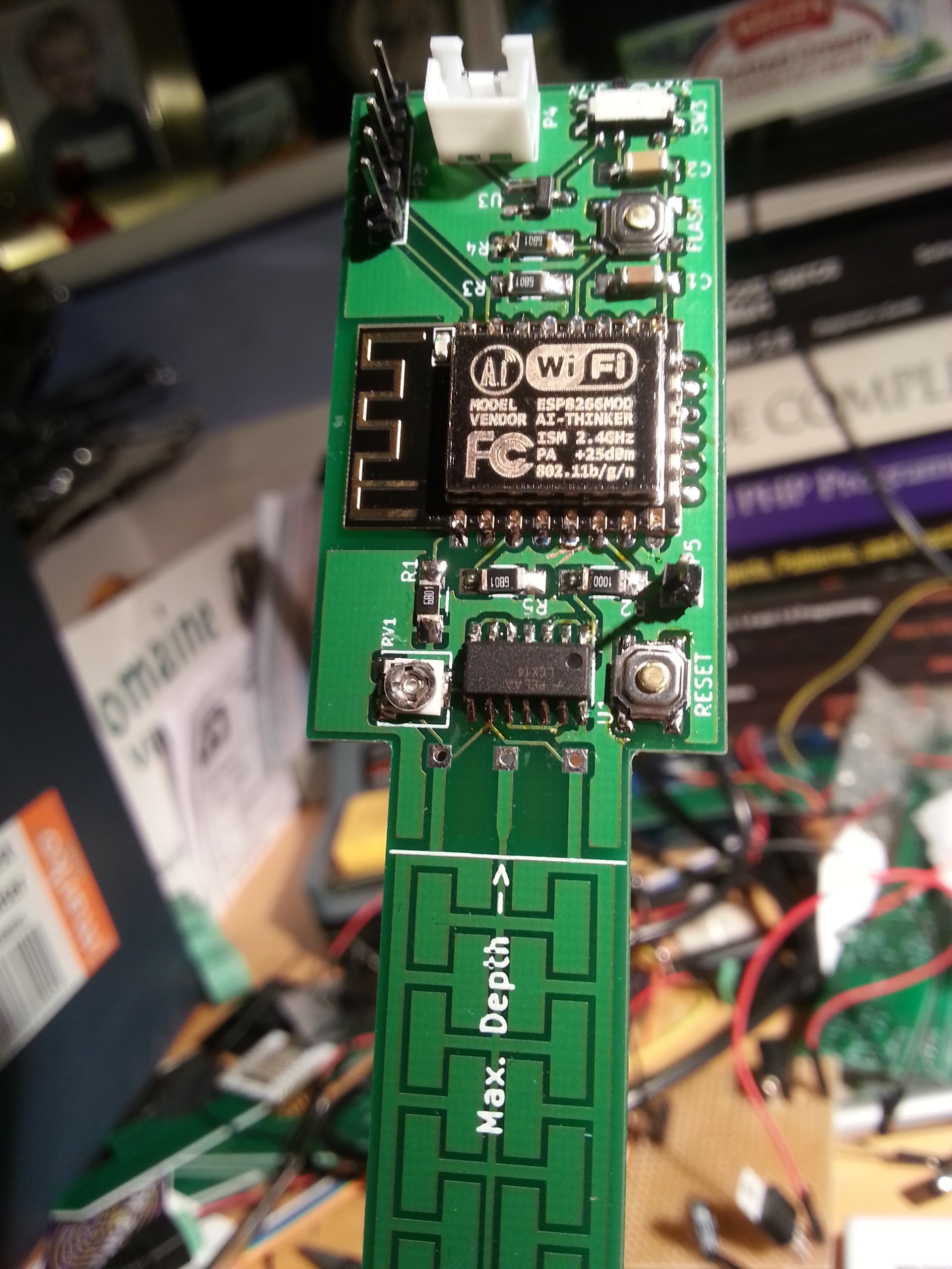

Hopefully I can get some time over the weekend to play with my new boards… I managed to solder one up for testing but not powered it up yet.
A Capacitive Soil Moisture sensor with built-in esp8266.

But i don’t see exposed metal to measure resistance… Does it work capacitively? That would be pretty cool!
@Moritz_Munst Yes. It is Capacitive. That is why I wrote “A Capacitive Soil Moisture sensor”

I’ll be interested in how the lcx14 is being used. I can see the wiring, but I still don’t understand it
. Do you have a capability for an external aerial there as well?
@Richard_Vowles The lcx14 is a package of 6 inverter gates with schmitt triggers. This design uses three of them. It basically converts the analogue oscillations of the capacitive plate to a digital square wave which I can use as an interrupt on a GPIO of the ESP8266 and simply count the pulses.
The ESP I am using is the 12-F which doesn’t have a connector for an external antenna. Other versions of it do I believe, but I have not had WiFi issues with these in my other devices.
@Richard_Vowles This is the one I used: https://uk.rs-online.com/web/p/schmitt-trigger-inverters/7390123/

@Moritz_Munst Yes, it is on Github (and some other projects too). The sensor works - kind of. But I need to spend some time working on the insulation material for the probe (It seems like epoxy is the best solution from other peoples’ experiences but now my plants are out and I am busy I don’t have much time to experiment…)
