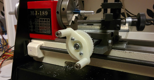

After a gazillion revisions I finally got to mount my 3D printed handwheels on my mini lathe (MJ-189, Emco Unimat 4 clone) and try them out.
It’s great to have resettable dials which the originals lacked and the larger size really improve the surface finish. I am using carbide tools on aluminum so mirror like finish isn’t to be expected but with the new handwheels in place it is much easier to maintain a constant feed and surface finish is actually beyond my expectations.
Very happy with these.

The thing about the real/clone Unimats from the time is that unless you get lucky accessories are pretty expensive and can be hard to find compared to other machines in the segment on the current market. If I’d start over from scratch I’d probably look at a Taig/Peatol (with larger spindle bore upgrade and brushless motor), Proxxon or Sherline. Proxxon seem most capable out of the box but Taig/Peatol sure is the most hackable/extendable and most value for money of the three.
