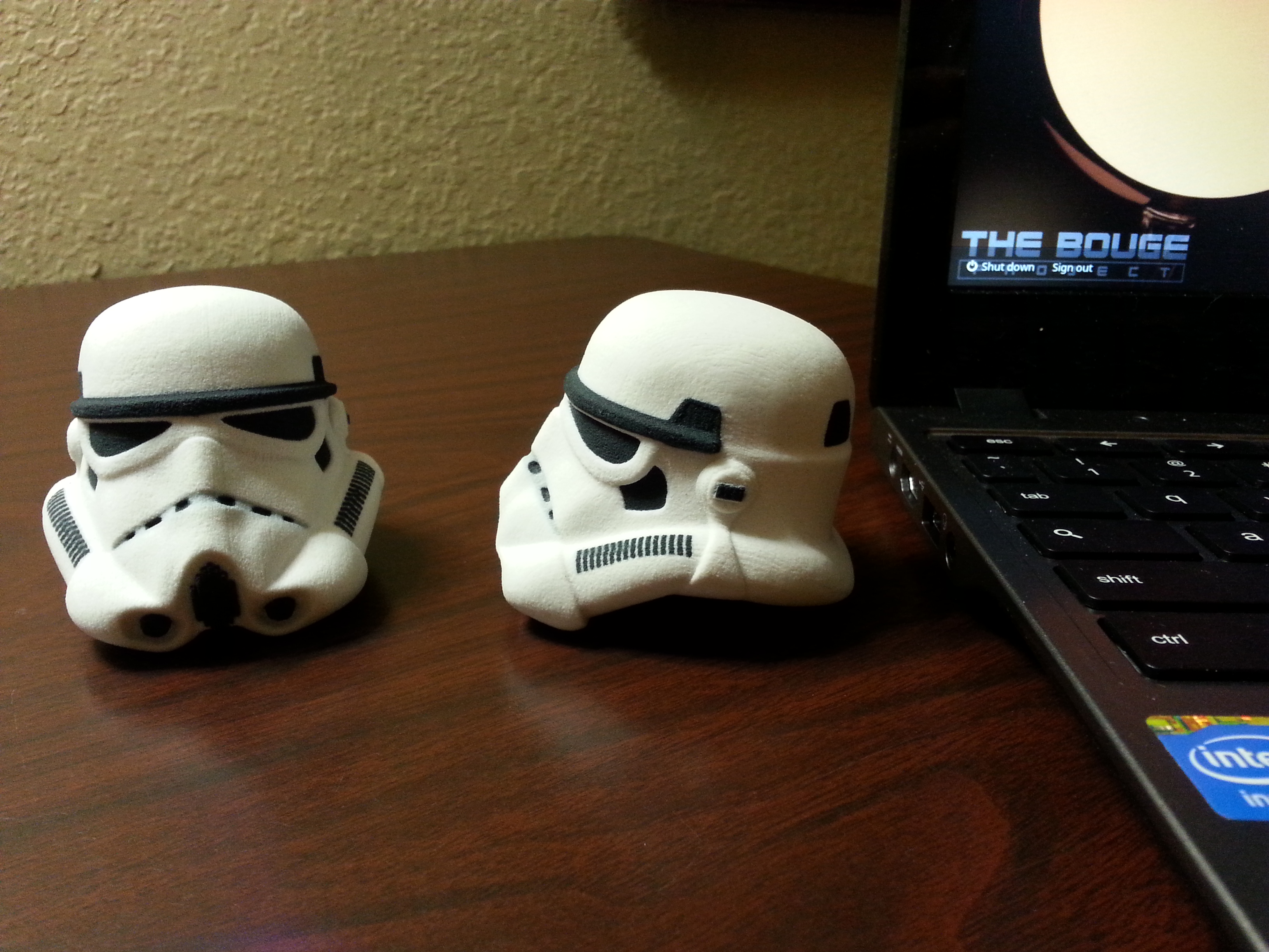

Originally shared by Andrew Bougie
Just finished some 3D printer training. Printed these on a Projet 660Pro on Monday.

Is it dual head or did you paint those?
I have always been impressed with the print resolution of the 3ds systems, but the plastic is terrible. it is brittle, has a low glass transition temp, and it in thin prints the layer adhesion is only okay. For making some things the FFF method is just better. This system i have not handled prints it has made.
@Robert_Hirsch @Camerin_hahn The ProJet 660 is a powder based printer with full CMYK color printing. I printed, sanded a little, and dipped in the 3DS ColorBond (superglue). No painting necessary! These have the feel and weight of clay or rough ceramic. With additional steps, they could even look shiny like plastic or metal, depending on the process you use.

A friend of mine has one. He showed me a colored printed bearing and I tried to turn it, instead it just crumbled into a million pieces. Nice to look at - only.
@Bruce_Jackson You make a good point. These printers output concept models. That said, it probably wasn’t infiltrated or finished properly. The bearing model works great when infiltrated with their ColorBond. Straight out of the printer though, they will crumble if you are not careful. They do have a StrengthMax infiltrant as well that makes the models much stronger.
