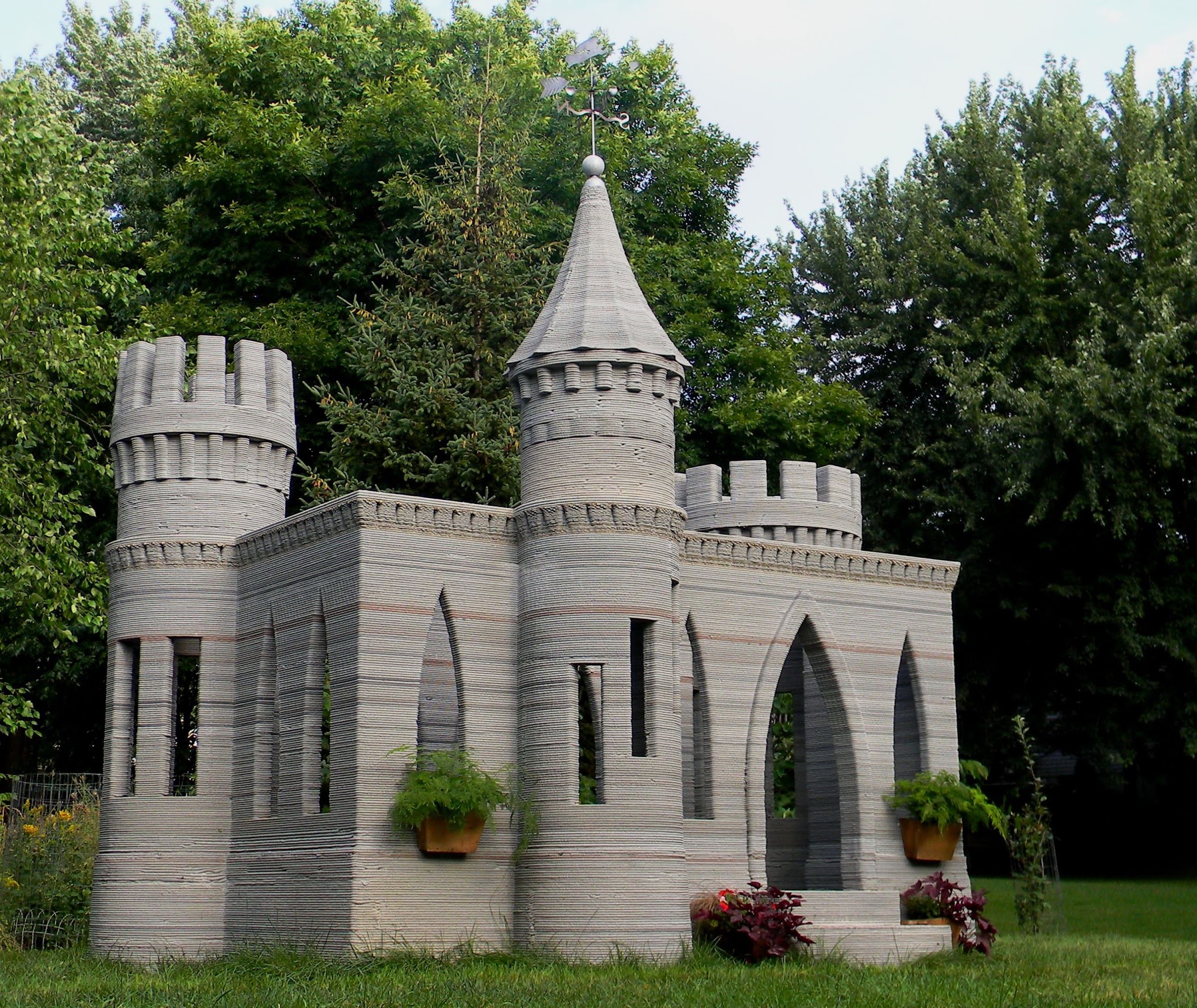

It has been two years since I first began toying with the idea of a 3D printer that was capable of constructing homes. In my vision of using 3D printers as new technology, I wanted a light, portable, and stable machine. First, I built a small 3D printer that used plastic for its main material, and from that, I started experimenting on enlarging the printer and using variations of cement mixes. Layering cement was an extremely difficult task- it required extensive tuning of the printer on a programming level, as well as using exact quantities for the cement mix. While testing the printer, I ran into obstacles (such as the nightmare of the extruder clogging) and discovered even further abilities of the printer, like that it can print much more than 50cm a day as I originally thought. I was able to calibrate the machine so that it prints nearly perfect layers now, and I played with various heights and widths of the cement layers. My current standard is 10 millimeters in height by 30 millimeters in width, but countless other options are available with just the click of a button.
This two year long journey has led me to build the world’s first 3D Concrete Printed Castle. Finally, it stands!
In desire to start the 3D printing of the castle model sooner, I relied on my own resources. When I started out, people struggled to believe this project would progress any further. However, I was lucky to get lots of invaluable input and support from individuals from the RepRap community. Specifically, I am eternally grateful to James Newton for his constant support with the drivers (http://www.massmind.org/Techref/io/stepper/THB6064/index.htm). These drivers ended up being the only ones to work properly with Marlin Firmware (I sampled other drivers, which failed), and were powerful enough to move such a huge printer. Also, I am greatly thankful for Mikhail Tikh, a design engineer collaborating with me on the project and responsible for the 3D model of the castle. I’m also really grateful for all the help I received with manual labor on this project.
Right now, I am in the process of redesigning the printer based on the lessons learned. My biggest priority is ensuring that the upgraded printer will be ready for the new project. My goal will be to print 24 hours a day until the project is finished. I’m also planning to print the structure in one piece; printing the castle turrets by themselves was a bad idea as they were extremely difficult to lift and place. Additionally, I’ve figured out how to print a roof; the only thing is that the material I’d print with would have to be used in warmer climates for now.
