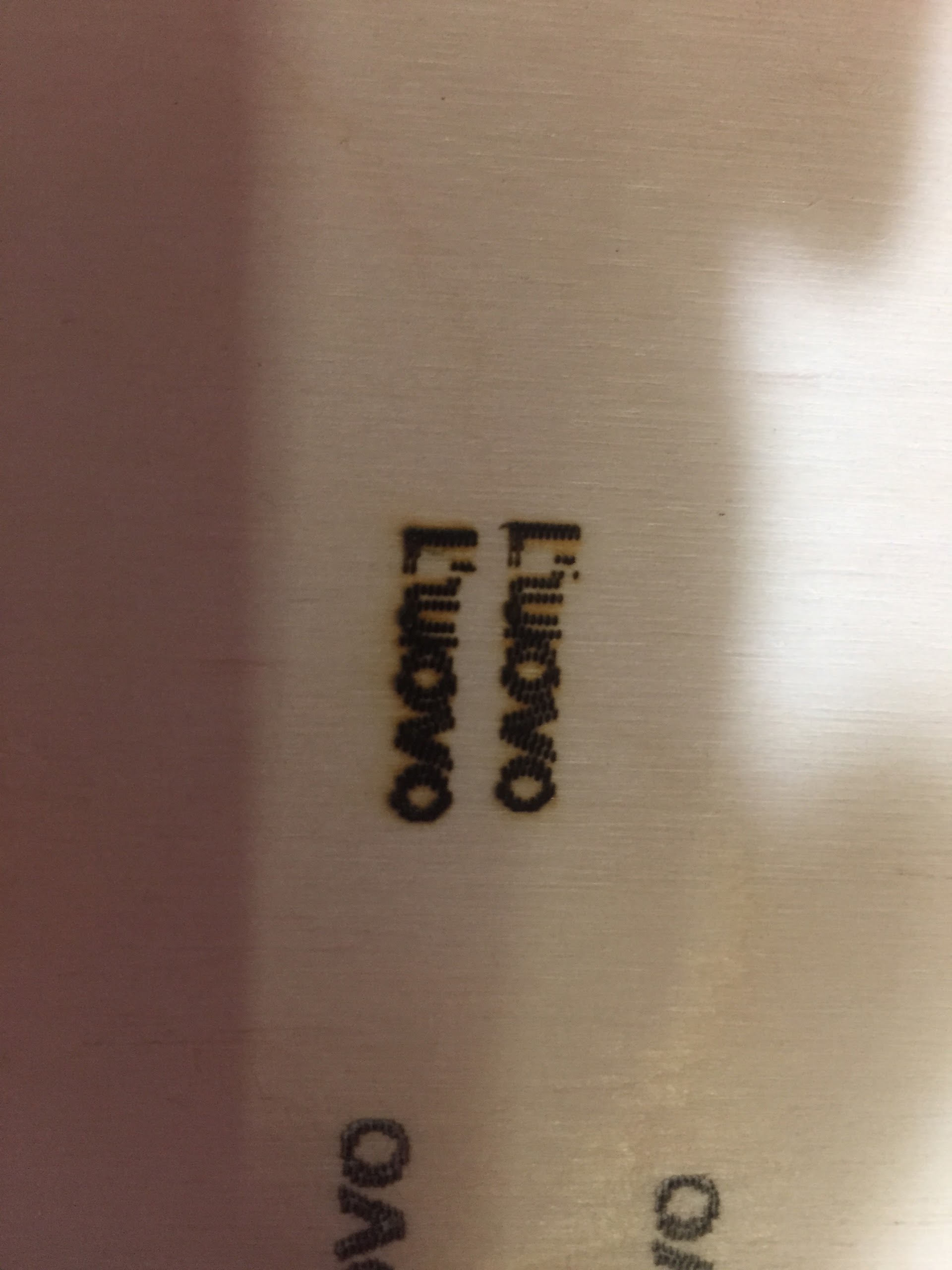

I’m going crazy. Somebony knows why my EleksMaker prints like this?
I’m using grbl ver 1.1e. The text i tried to print is “L’uovo”.
Someone can help me?
This looks like you have a big backlash on your machine. You need to check your belts and pulleys, as well as your accelleration settings.
