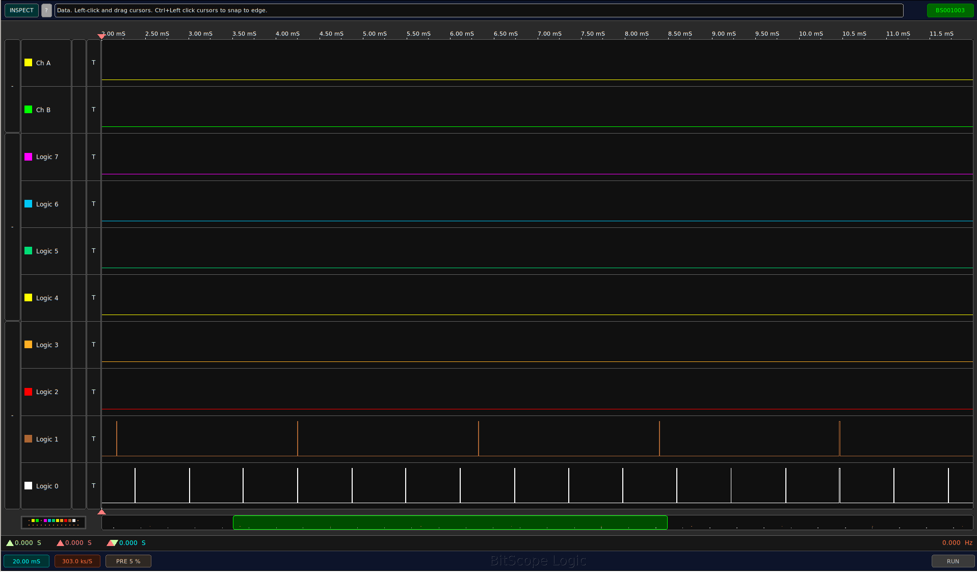

Originally shared by Arthur Wolf Smoothieboard v2 pro generating steps.
This may not look like much, but it’s actually very good news.
Smoothie2, the port of Smoothieware to the v2 hardware ( LPC4337 ), is now capable of :
  • Receiving Gcode over serial ( uart only, no USB yet )
  • Planning movements
  • Generating steps to control stepper motor drivers
The picture, is those steps, read by a logic analyser.
This means that technically, I could right now put the v2 board in a CNC mill, laser cutter or CNC plotter, and actually use it to do useful things.
Pretty cool right ?
There is still A LOT to do, but progress always feels good.
As always, if anybody is interrested in helping with this firmware port, any kind of help is extremely welcome. Contact me at wolf.arthur@gmail.com
Cheers all :slight_smile:
