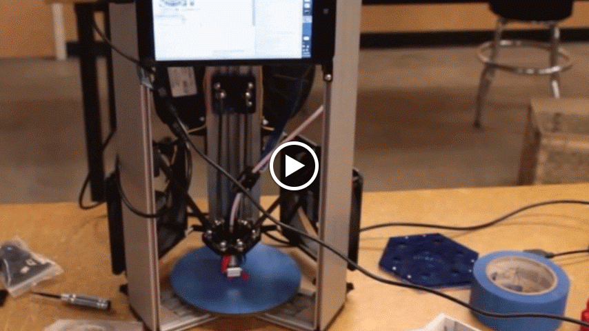

I finally have the HP Stream 7 running an actual print on the ZEGO. I’ve had it plugged in for 40 minutes or so now with full brightness and charge level is stable. It started at 50% battery and each time I’ve checked it still is at 50% battery.
So, how is the printer connected to the tablet? USB? We were looking at these for some ideas at work but were concerned about the limited USB connectivity.
A regular OTG USB cable will connect but connecting and charging/powering at the same time requires something more elaborate. Here I am using a special splitter for the Dell Venue Pro 8. The Internets says a regular splitter does not work but maybe it does work as well as this one does.
