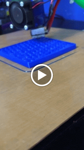

I have been playing with many different materials with respect to filament on TSP. This is partly related to the bed. I’ve tried a grouping of different materials for the bed, one has me puzzled.
An aluminum printed bed. A number of manufacturers use it on their printers. I am having a hard time getting certain PETs, ABS, and NinjaFlex to stick to it, bare.
My question, for those that run an aluminum print bed:
Do you have to apply anything to it?
Glue, tape, ABS juice,…
What surface finish do you have? Brushed, polished, machined…
How high a temp do you typically print at?
Have you seen deflection due to the heat cycles?
