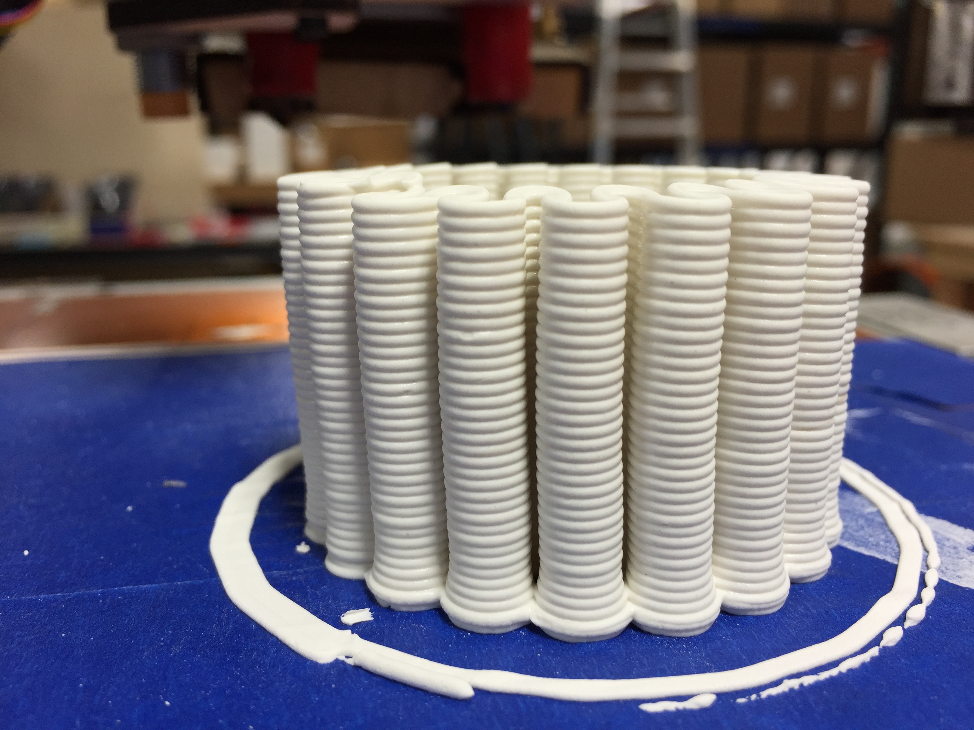

Printrbot paste extruder beta is finalized. We have been working on it for a few weeks with Mark, our printrn. It’s his first Fusion 360 project taking my scribbles on paper and daily tweaks and turning it into a product.
We learned a lot in the process. This beta is for those brave enough to work through a learning curve.

With this material and model, you end up fighting gravity and struggling to ride the fence between under and over extrusion. Better models should reveal techniques to make gravity work for you not against you. It’s definitely not a “just print a spiral vase” type thing. You have to create a pattern that holds its own weight. With the print material being so cheap and flexible (just add water), and a couple of fans helping you cheat gravity a bit, it’s easy to get in a groove of successful print runs.
I consider this type of printing art, so embracing unique characteristics, flaws and even failures has put me in a happy frame of mind to really enjoy this!
Brook
