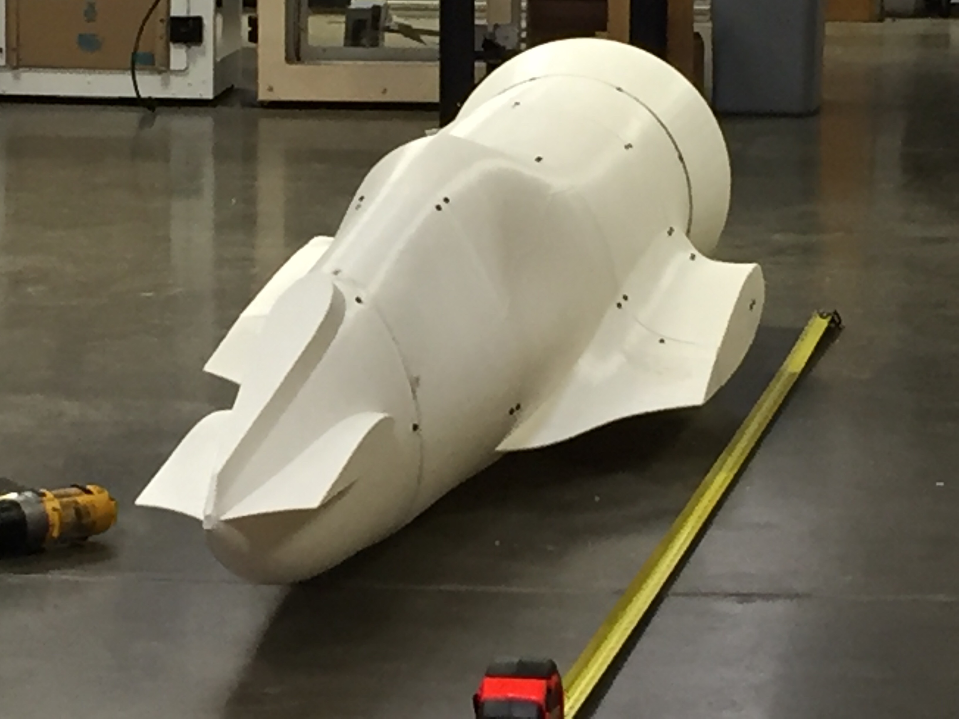

The Printrbot Hughes H1 Racer designed by Andre Roy is coming along!
*Crazy long post ahead. You’ve been warned!
I’ve been slow to show the prints because there are definitely problem areas and learning that comes along with printing on the Printrbot Big-E… 1mm tip, .8mm layer height, single wall prints at 50mm/sec (if memory serves). But while some sections are rough, it’s just too cool not to share. You are getting the down and dirty real deal here.
We where getting great prints, all things considered, until we switched to 5 or 10kg rolls from Breathe 3D. I love there PLA++ but the machine was resonating badly pulling the weight of the spoils, so we built a powered filament motor setup that needs dialing in. Some walls suffered from our experimentation.
Being the impatient hacker that I am, I just said screw it and continued printing… Nothing that a skin coat of bongo can’t hide ;). So far, the fuselage with cowl is 10lbs… So I’ll have to add maybe 3-5 lbs of bondo to cover my sins… That may push this first test print over the edge to a non-flying display piece, but no matter, I can print more. I figure we’ll crash the final one (I’ve never built s plane, quadcopter or rc car I didn’t crash
