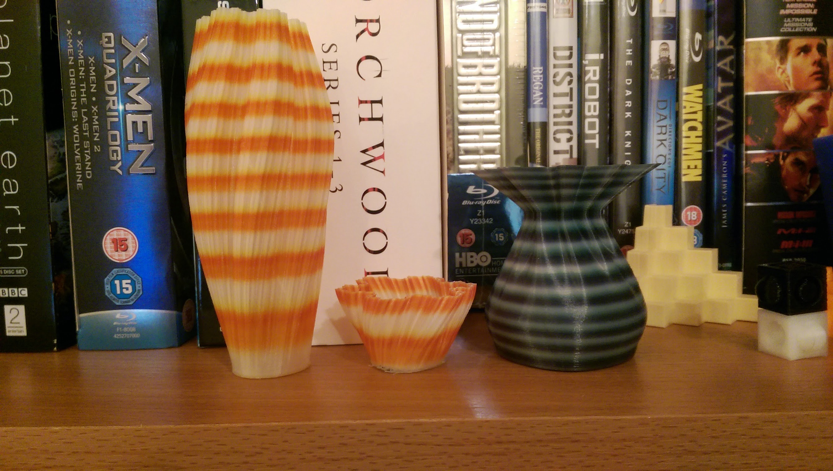

Originally shared by Colin Bell Finally got the Printrbot Simple Metal producing great quality
Finally got the Printrbot Simple Metal producing great quality nylon models. These are printed using Taulman 618, dyed with Rit, at 0.1 layer height at 245c . I got them stuck to the unheated bed using Kapton and Gluestick.
My question to the community is what can I use nylon for other than pretty vases? Does anybody have any models that would benefit from this type of material over PLA or ABS?
