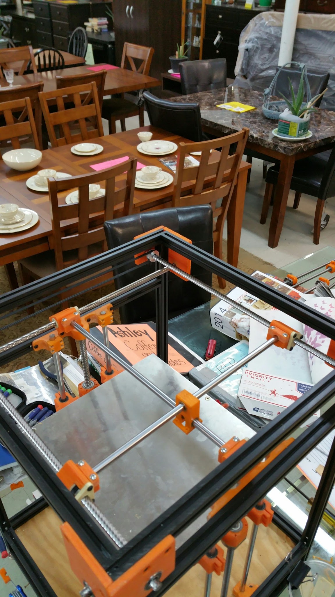

Originally shared by D Rob
Move along folks nothing to see here. Just regularly scheduled upgrades and maintenance.

what kind of speeds can you achieve with this? are the motors directly coupled to the shaft?
They are connected to the Motor via pulleys and belt. The motors mount outside on the frame and have gt2 36t pulleys on the Motor. The screws have gt2 32 10mm bore. They connect with a 600mm gt2 belt. The pitch is 1050 so 200 steps=50mm with 1/16 stepping 3200 steps=50mm
