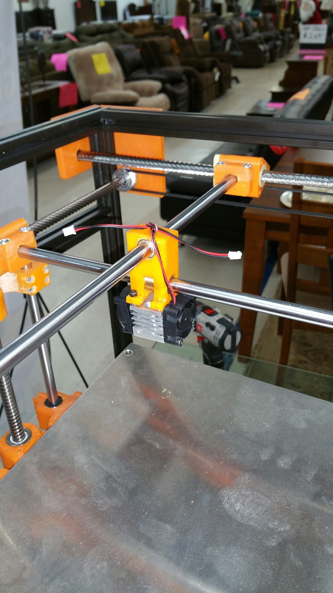

Originally shared by D Rob The Hydra with its shroudless direct bolt on fans.
The Hydra with its shroudless direct bolt on fans. The fans just hit the base of the rod clamps on the x/y ends :confused: changing print area to 12 x 11 ⅝. I’m not happy. The STL will be fixed by shaving off 2mm and I’ll file these down so that I don’t have to reprint and disassemble.
