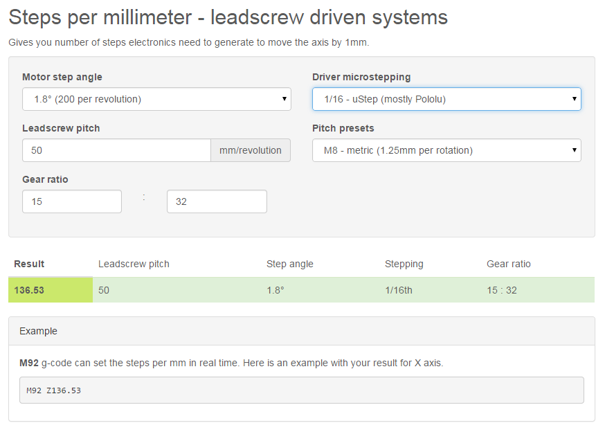

Originally shared by D Rob
using 1/16th micro stepping the UL-T-Slot will have 136.53 steps/mm if I use 15t g2t pulley on the motor shaft with the 32t g2t 10mm bore pulleys on the screws. And I can always get mendel 90 type res by backing down to 1/8th micro stepping. Any thoughts? Oh yeah with 20mm Pulleys on the motor it will be 102.4 steps/mm. Lets take a vote on which I order. Discussion… Begin!
