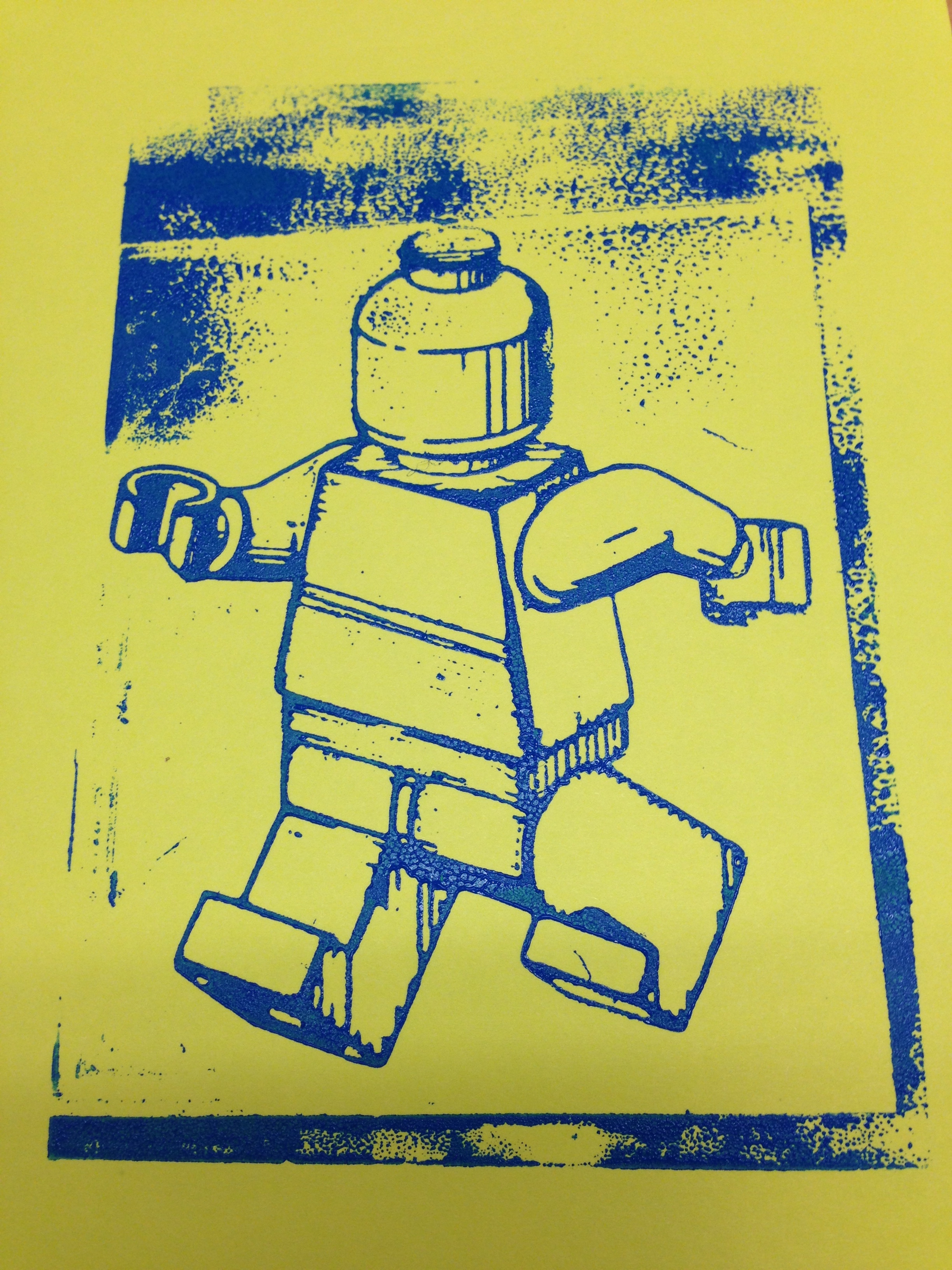

Originally shared by Dana Spisak Shapeoko used to create a stamp from Lego mini
Shapeoko used to create a stamp from Lego mini fig patent drawing
Nice what material do you use to make a stamp? Does it machine well?
also, what software did you use for CAM? I’m assuming this was a 3d cut? Or perhaps it is all just a single layer and everything is pocketed around it (2.5d)?
It’s linoleum mounted on mdf from Hobby Lobby. Machines nicely IMO, but I don’t have much experience for comparison.
I created the SVG from the patent application image in Inkscape. Easel.com was used for design and CAM.
Cool! I just bought a piece of linoleum from Blick today for that very purpose did you use Easel as gcode sender too or just to generate the gcode?
Universal g-code sender
Neat! I was thinking about making some lino stamps on my Shapeoko!
