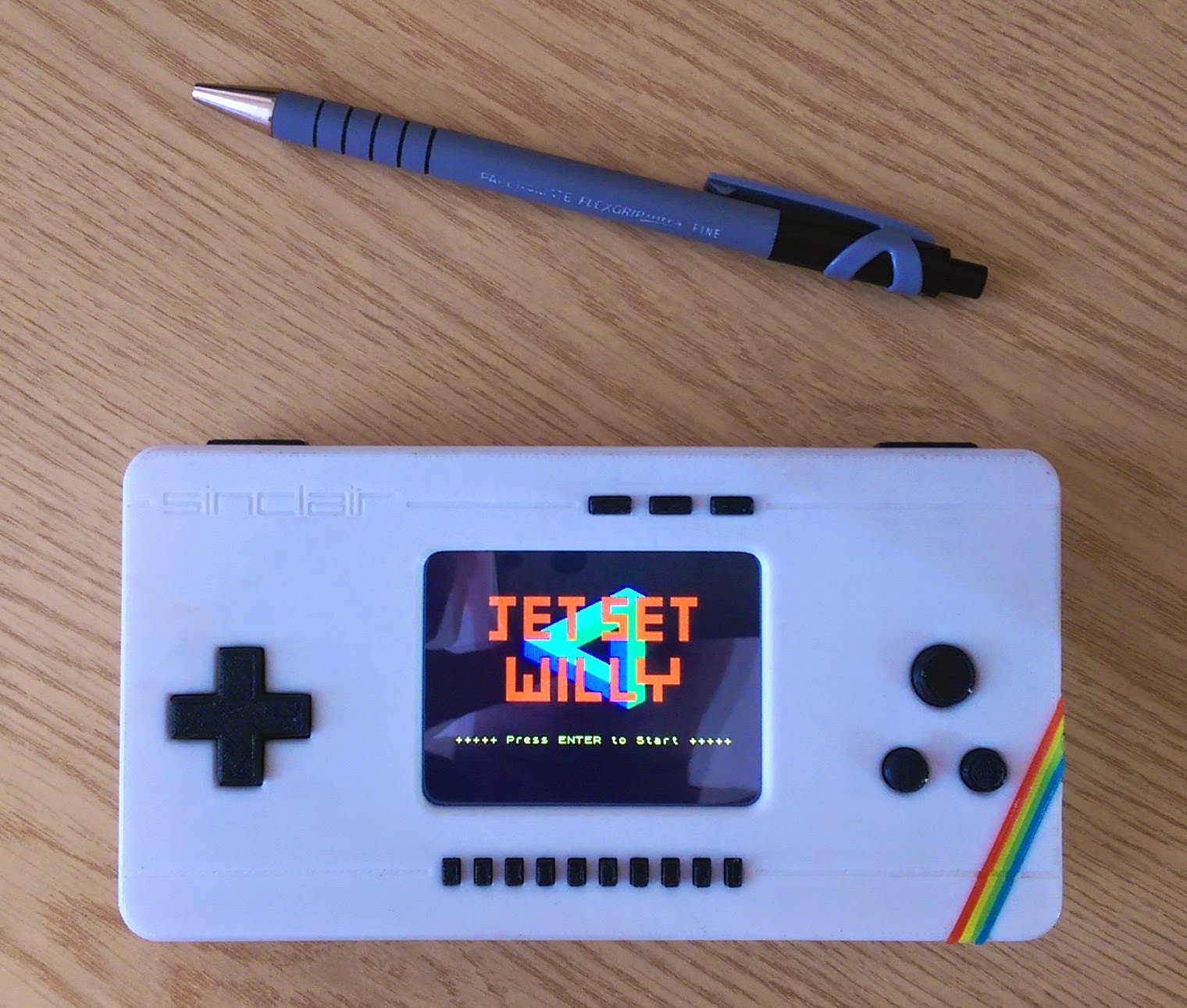

Originally shared by Daniel Bull My latest project,
My latest project, a hand held ZX Spectrum :slight_smile:
Believe it or not I started this way before Ben Heck, I’ve just been taking ages to get it sorted :slight_smile:
Its still a rough/fast 3D print until I get it all right but its together and working!
For those interested in the details…
HARDWARE:
3D printed PLA plastic case
3D printed NinjaFlex rubber buttons
Odroid W single board computer
PiTFT display
Old DECT phone batteries
Edimax wireless dongle
LM386 amplifier module
Old Dell laptop loudspeaker
Lots of microswitches hand wired on prototyping board
Lots and lots of wires, lots of cramming it all in and lots of time :slight_smile:
SOFTWARE:
Raspbian OS
Custom Kernel
Fuse-sdl emulator
Adafruit Retrogame
WiringPi
1000/500/500 Overclock

When I get the final print for the case done I might do a small video.
