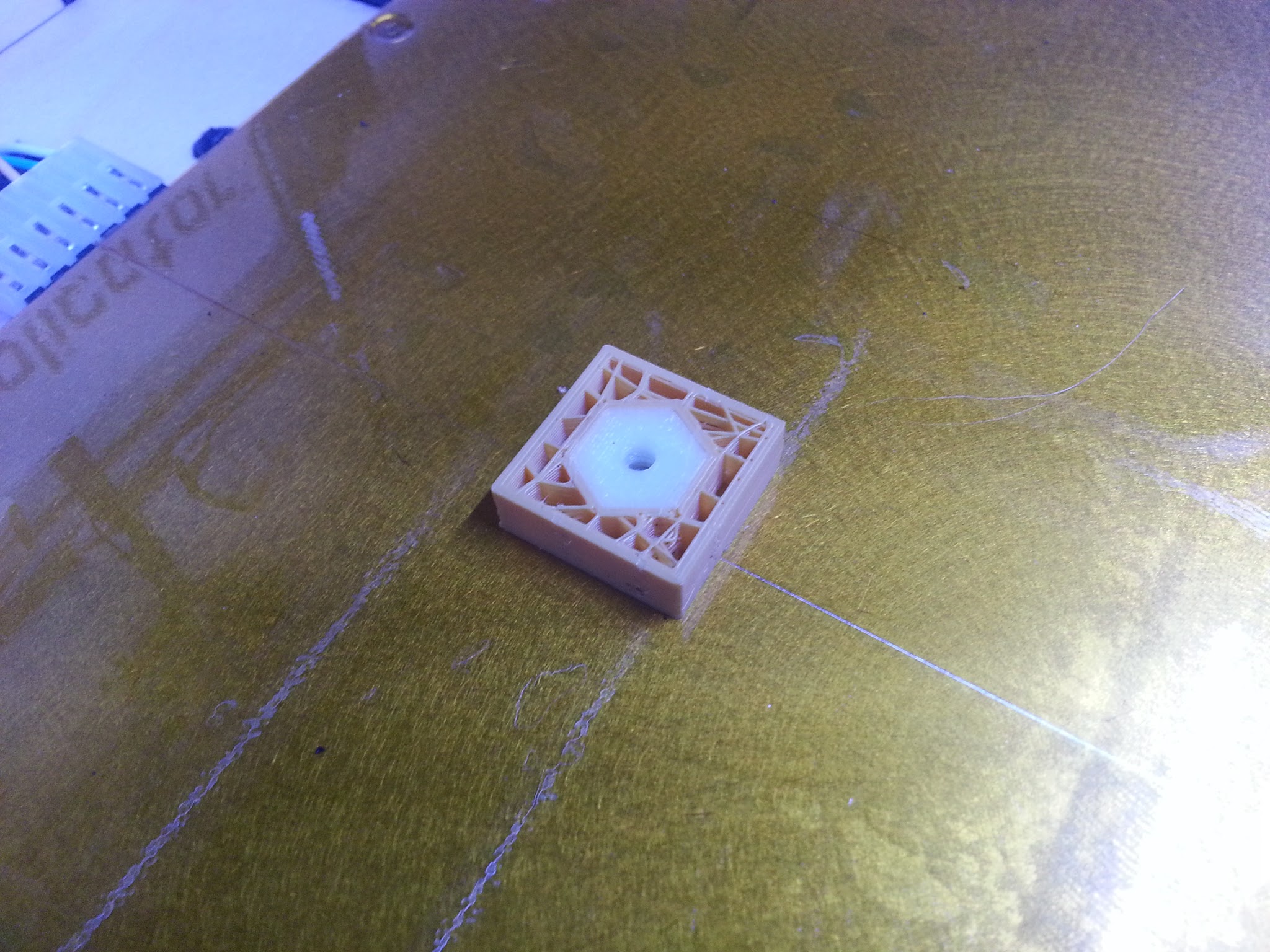

Dual extrusion test. The outside is ABS plastic and the core is Nylon “618” Filament. Prints great! =)

What kind of printer setup are you using?
Makerbot Replicator. Everything stock except Sailfish firmware. Nylon printed w/o problems at 245 C.

What temp are you running on the build plate? and where did you source the 618 nylon?
You can get 618 from here: http://www.taulman3d.com/index.html
Thanks – just ordered 2lbs. Hope my print looks as good as yours.
How are you preventing the dual extrusion drool issue?
@Mike_Walker Nylon extruder @ 245C
ABS extruder @ 230
HBP @ 110C
@Dave_Lockwood Nothing, the “drool issue” is there.
