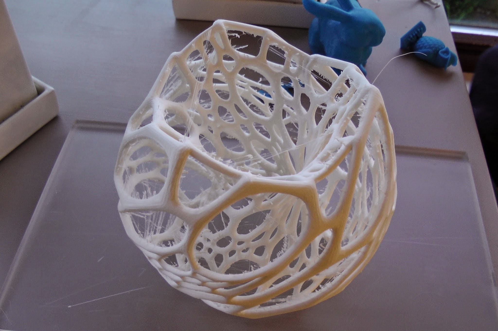

Does somebody know how to avoid unwanted printed little filaments as we can see on my photos?
I printed on a #makerbotreplicator2 with those settings:
layer height: 0.1mm, 0% infill, number of shells: 3, temp.: 230°C, speed while extruding: 30mm/s, speed while traveling: 80mm/s
#3dprint #design
KISSlicer has a “Wipe” option - I’ve wondered what that does, and if it aids with the retraction settings?
That option causes the printer to wipe the extruder backwards a bit over the print after retraction to clean off any excess.
@Ashley_Webster What do you mean exactly?
I use Makerware… should I manage to learn another software (on Mac)
I fixed this by reducing the retraction speed (counter intuitive). The extruder was missing steps and ultimately not retracting at all.
@Matt_Harrington Which software and printer do you use?
Am I able to do that on a Replicator 2 using Makerware?
Assuming it’s ABS, try lower temp, in addition to tweaking retraction.
@Jay_Ward I’m using PLA :wink:
In fact, retraction parameters are not available through interface in Makerware, but they seems to be accessible through the JSON file. Does somebody know which parameters to modify and how?
@Dominique_Vienne I have no idea about Makerware; I’m using slic3r which comes with its own challenges. Perhaps retraction can be configured in your firmware somehow.
@Matt_Harrington Do you know the labels of the modified parameters and how you modify them?
