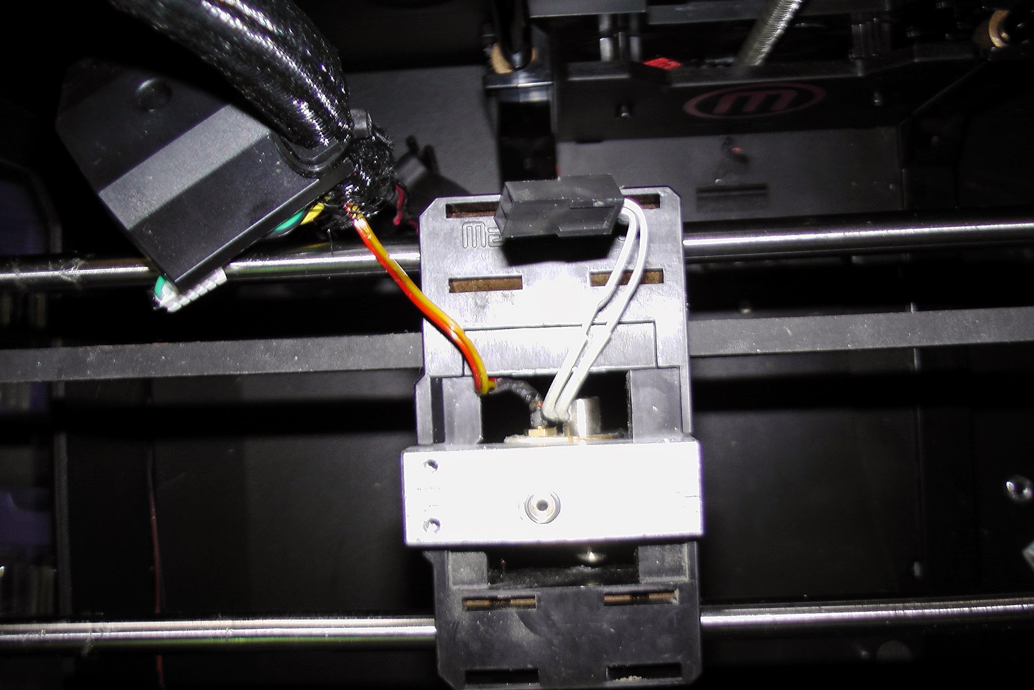

Having my #replicator2 for less that 6 months and already have some thermocouple issues. I used my printer just normally.

Makerbot support told me the thermocouple wires (here in yellow and red) should not bend… but there is no place for the cable to pass through.

As you may see on the pictures, the thermocouple cable is damaged which is not due to anormal usage but, from my point of view, a misconception The cable is intended to by straight on almost 5mm… which is quite impossible here due to X axis chains.
This thermocouple failure is not due to a lack of maintenance…
Oh right. Sorry. Your totally right. Their wire routing/planning is god awful. We had the wires fatigue on the y axis as well. Lost all the connections to the motor and limit switch. May want to check that too.
