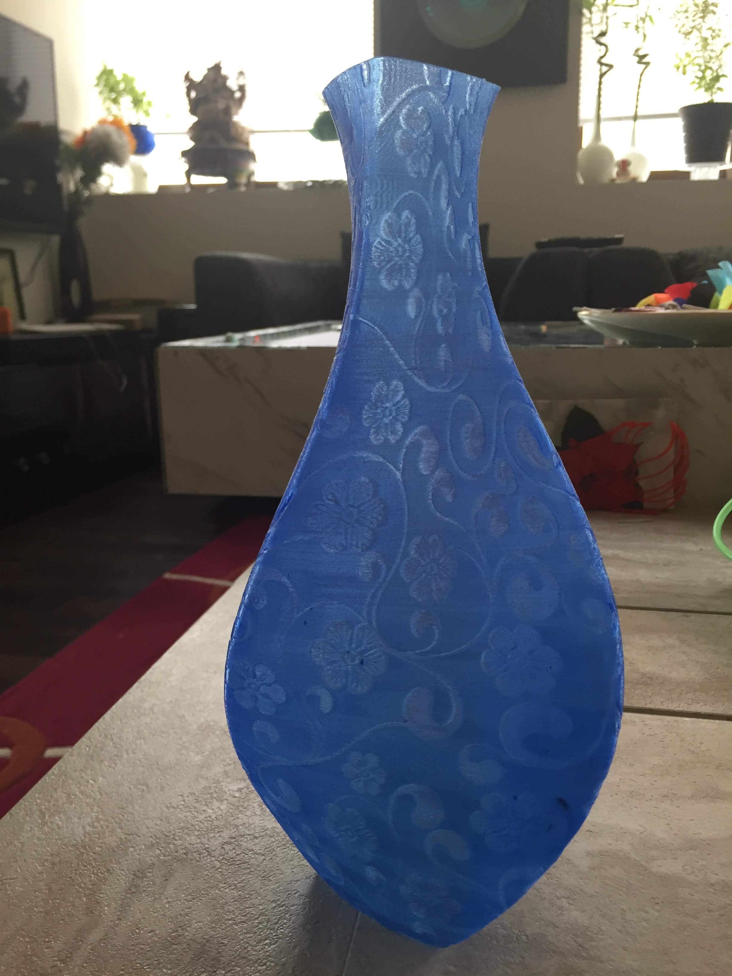

Originally shared by Dushyant Ahuja Vase velocity painted using the latest version of repetier
#VelocityPainting
Vase velocity painted using the latest version of repetier and slic3r prusa edition.
Great results, cool design.
This is the stl. https://www.thingiverse.com/thing:745879
I downloaded a black and white floral pattern from google images and applied it using velocity painting.
Repetier has now included velocity painting as a function. Makes it extremely easy to use.
