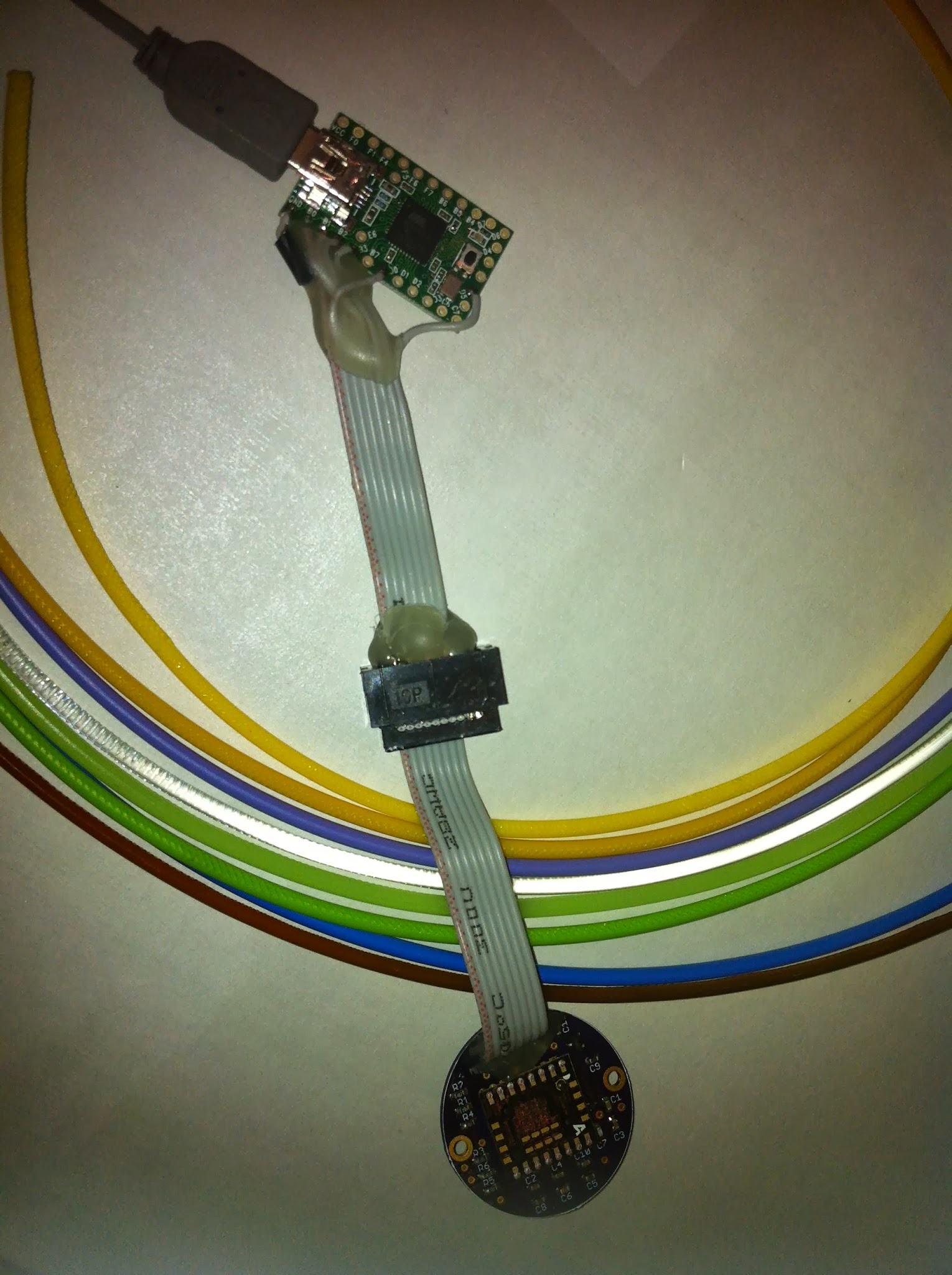

Originally shared by eof cr lf Optical test components Teensy 2.0 / ADNS-9800 Optical Laser
Optical test components Teensy 2.0 / ADNS-9800 Optical Laser Sensor and 8 different filament types ( Big Thanks to +Kristof Deruyttere ).
Goal is to verify if the surfaces are suitable for the optical tracking.
The extruder gear teeth markings should be enough.
Had prepared a test tube: lens-sensor-moving filament, but made a mistake on the focus thus next (without for error) trail (and error).
Test results follow… (damn need more spare time, who doesn’t?)
are you looking at filament dimensions? or just movement
@Joe_Spanier only looking for movement. Volumetric’s main part is linear feed.
