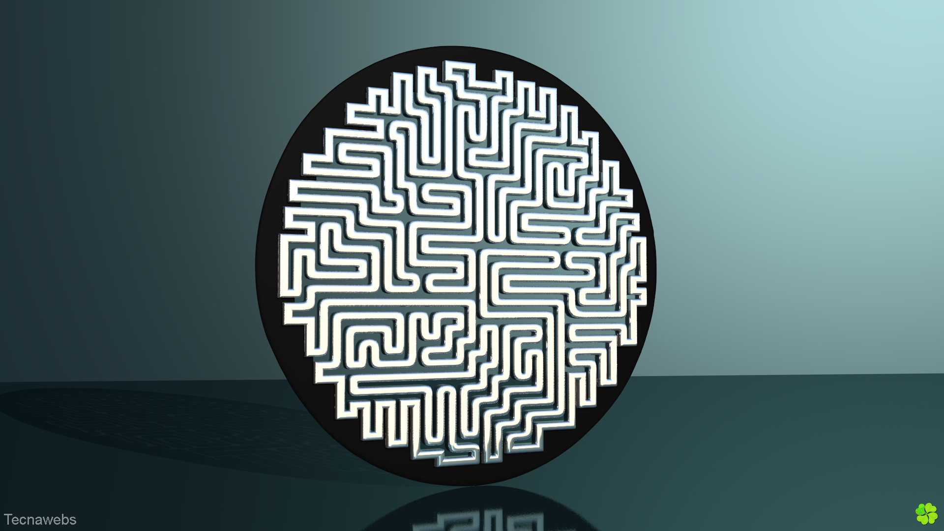

Originally shared by Eugenia Martín New versions of the labyrinth I made 3 new
I made 3 new versions of the maze based on feedback, to make it more robust.
1- With an outer frame. It is what I like, but I don’t know if it will be solid enough.
2.- On a circle and the labyrinth negative. To put a ball inside and cover with a transparent acrylic. I think the walls are too thin.
3 - On a circle and the labyrinth positive. It could serve the same purpose as version 2 and I think it is the most solid.
I have also tried different combinations of materials. Render Blender Internal.
Very attractive! Your option two would not have to factor in thin walls if all of the walls were adhered to the covering acrylic. Even the acrylic could be microns thin as the outer ring would provide additional strength overall.

The old version without reinforcement, which is the first thing I printed, was 3 mm thick on the walls of the maze and the separation between them was 1.5 mm. In version 2 would be the other way around, and if feasible, think it will be a bit tougher increasing the thickness, but also need more material.
My models are more oriented to animation and although many think they are too complex to print, others believe that they would be worth. I always try all the meshes meet conditions (manifold, without intersected or distorted faces …) and check the test print Blender. I don’t knwo if it is very reliable because I had never printed anything so far.
