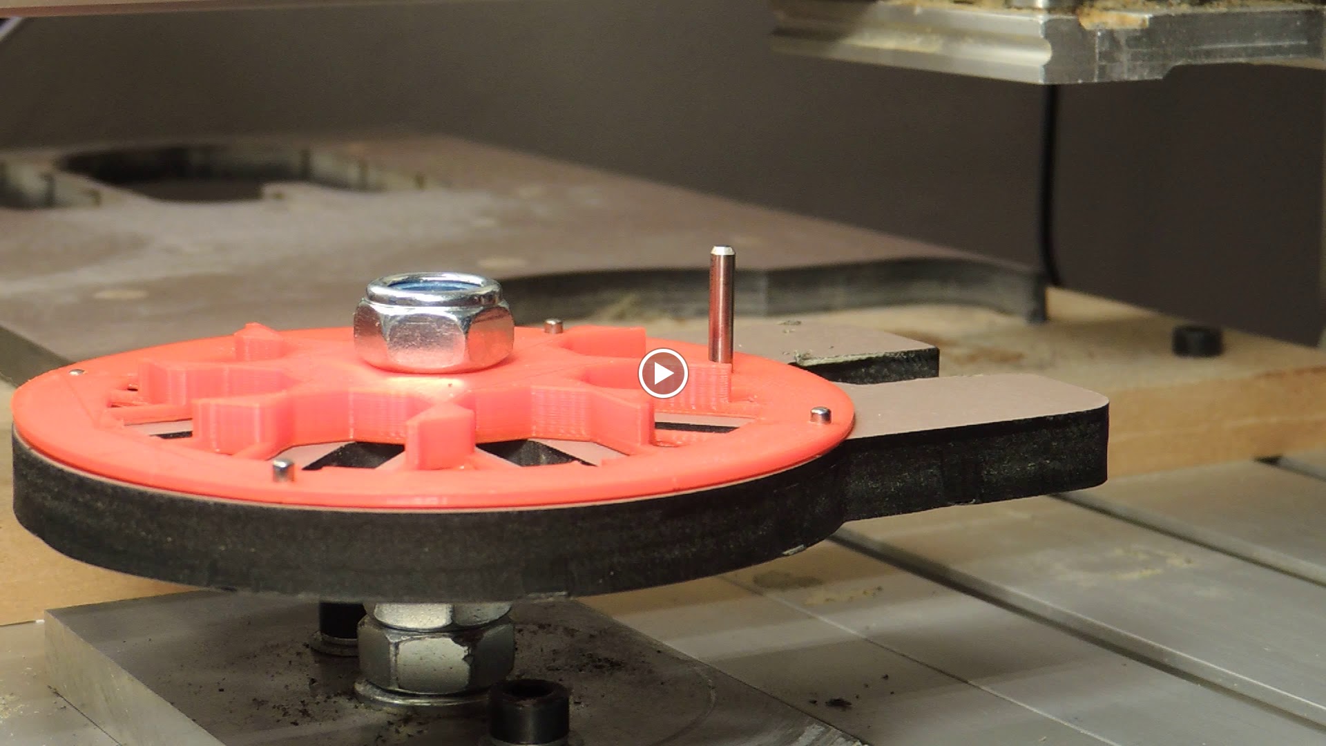

Here some Videos and Pictures from my new Catchframe and Carousel, i was so close to finish this project … man
