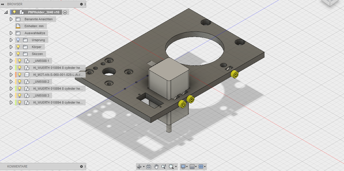

It’s time to design my old PNP Holder on Fusion360 and it’s easy cuz the data and measurement are finished in cambam and i have to copy this to fusion. Here a screenshot of the first design. The yellow screw’s press the Stepper motor or shaft of the gauge clock to the frame and hold them in position. I steal this idea from my 3d Printer set
I mill this the first time with my new favorite Material (HPL - High pressure material) extrem stiff but easy to mill, perfect for my project. On the pics you see some parts combined with this frame, my Solder Dispenser Auge and the M12 threaded rod for hold on my cnc machine.
