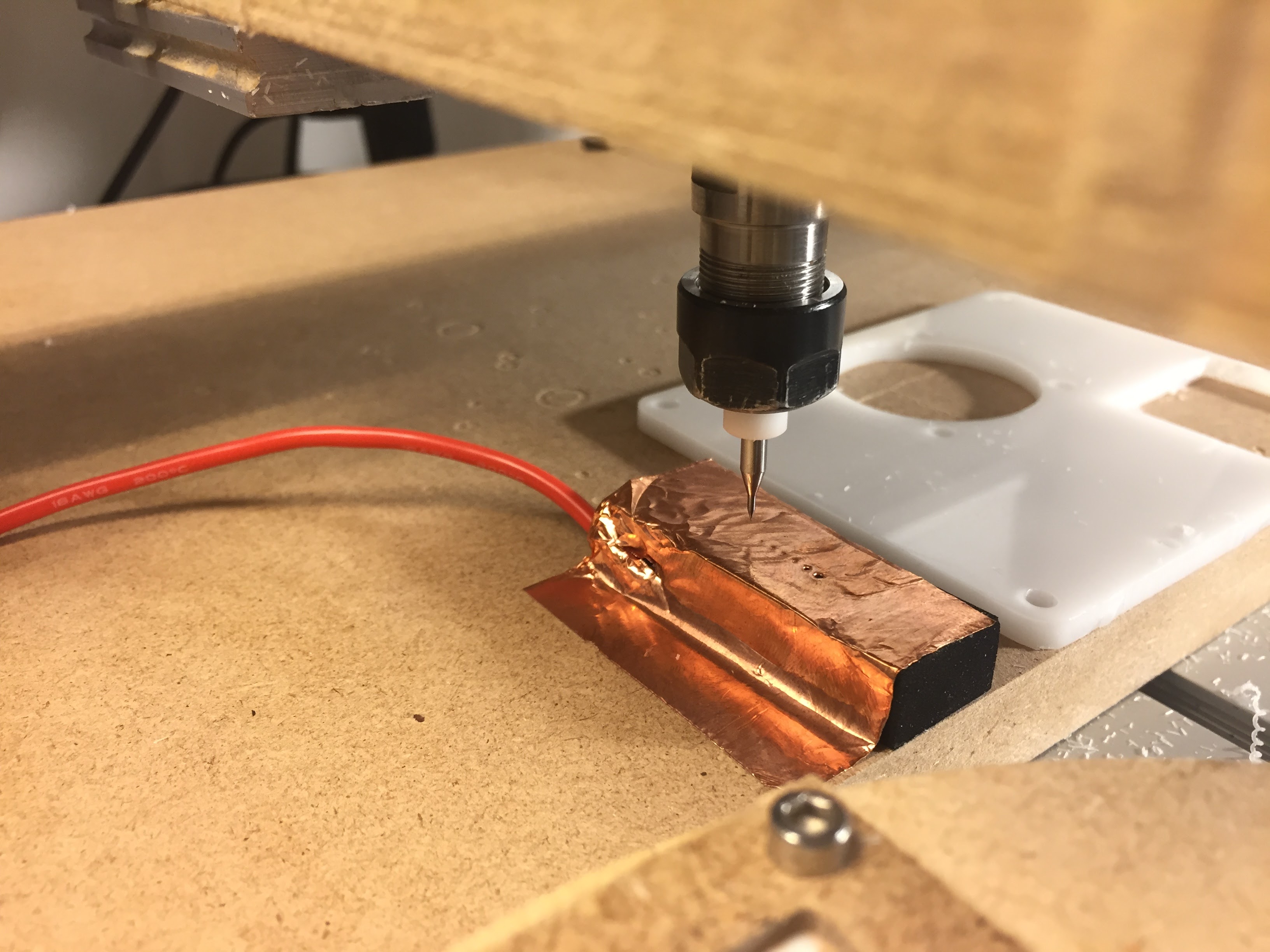

Ok, here my small experiment. I used a rubber-foam block, very thin Copper tape, broken sharp endmill and strong nerves I glued the block with copper tape on my worktable and test touchprobes via Touch-Plate Widget with different feed speed’s. If the speed to fast, then we will see a hole or a point after probing.

Here my Results on the second photo: the best Feedrate w/o Hole or point if between 100 and 150 mm/min … in the next days i make some test with an mdf or alu/steel surface.

@cprezzi I’ll use this “touchplate” for my automatic toolchanger, i need a more simple solution. I want to put this coppertape on the surface of my workpiece. The position is close to the zero point of the workpiece and i can check the Z-Axis-Zero after every tool change. Just an idea.
