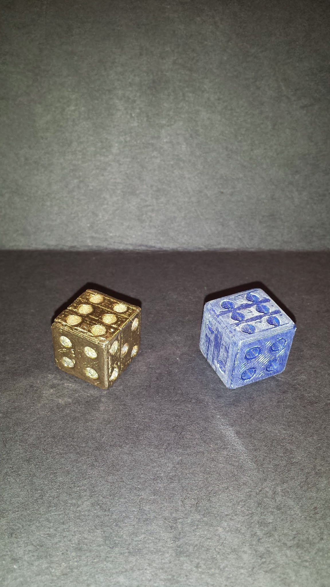

Here are a couple of pictures of the 3D printed dice that I centrifugally casted into Brass, using the lost wax process.
Fantastic job, nice and clean.
couple=1?
Nice cast
I heated spru wax up and stuck them to the dice. Then I heated a metal wax tool up and remelted the wax to the plastic to make a smooth transition.
