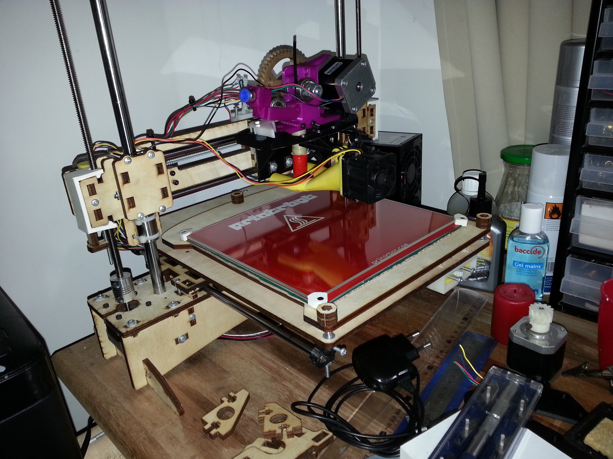

Originally shared by Hoani Cross
Sneak preview of my WIP modifications on Printrbot+ : Y-Axis stabilizer (from http://printrbot.com - installed), bed leveler (from printrbot - installed), GT2.5 pulley 608ZZ adaptor for Y-Axis stabilizer (installed but not visible, self derivation of http://www.thingiverse.com/thing:29687), Quick-Fit for original X-Carriage (installed, self derivation for larger extruders, like the budaschnozzle, with fan duct adapter of http://www.thingiverse.com/thing:27617), Quick-Fit Greg’s Hinged Accessible Extruder (self derivation of http://www.thingiverse.com/thing:27887) with self designed idler with push-fit adaptor for PTFE tube, fan duct adaptor (self designed) and fan duct (http://www.thingiverse.com/thing:29985). Still waiting for the Super-Z
