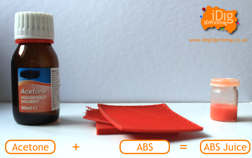

Having problems with first layer adhesion for ABS and ABS warping then why not try ABS juice.
all you need are:
Acetone (available from high street chemist)
Discarded ABS
Acetone resistant, air tight container.
ABS is a good filament for ‪#‎3dprinting‬ but it is prone to warping. Other filament materials also benefit from using a layer of ABS juice on your 3D printer bed.
