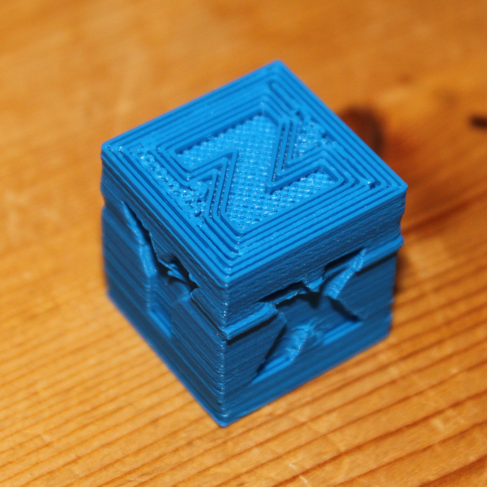

So we have been engaged in building a Prusa i3 ( https://www.idig3dprinting.co.uk/news/building-3dprinter/part-1-where-to-start/ ) #3dprinter and although we haven’t finished writing about it we have finished building it. Here is our first print!
It’s come out quite well, there is a jolt where the filament got caught up but we are printing a spool holder now to get rid of this annoyance.
This is our Ingeo PLA ( https://www.idig3dprinting.co.uk/shop/3dom/ingeo-pla-filament-sky-blue/ ) 3D printer filament, printed at 0.1mm & 210C. We have more tweaks to make though.
