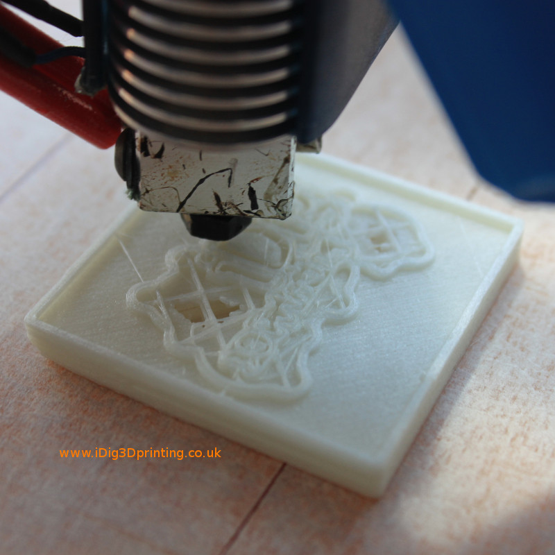

Today we have mostly been #3Dprinting with PVA and Laybrick filament.
The Laybrick (RHS: beige colour) was quite easy, although it did keep snapping whilst we were trying to feed it into the extruder. But that was a brief and minor irritation.
PVA (LHS: white colour) proved to be slightly more tricky. It took a couple of goes to get it to stick. In the end we used a bed temp of 60C on Masking tape. The trick was to heat up the bed and extruder first, in manual mode, and manually extrude some filament before we pressed run on the print.
