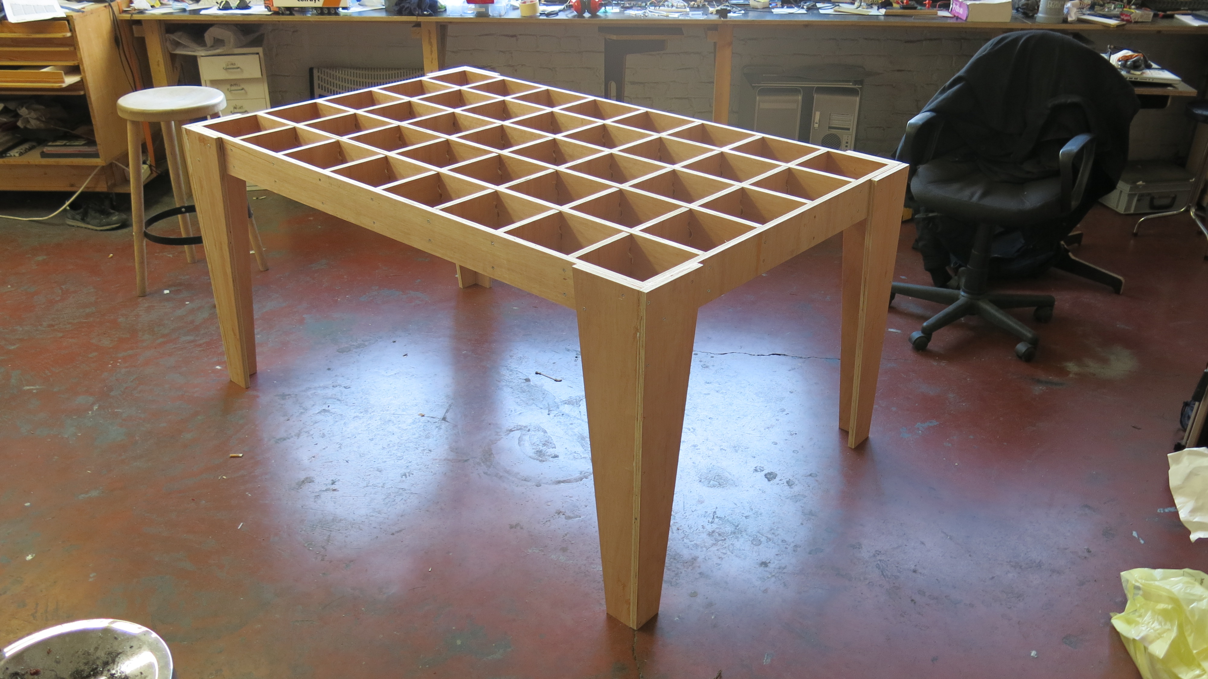

shapeoko 2 upscaling to 1x1.5M + dedicated table / taflon spacer for Xaxis and reinforcement on all axis

Nice torsion box table. Looks very similar to the one I built for my OX CNC
Very nice table !
I’m just curios, are some light gray pieces milled from an IKEA Breakfast board?
@Frank_Herrmann yes the “whiteish” pieces are Ikea cutting board ( actually some sort of nylon/delrin ) easy to machine and work with and strong enough annnd really cheap to rapidly try and prototype also ( around 1.3euro / board )

Good choice on the table design. My torsion box table is so flat it might as well have been milled from a solid piece of aluminum.
