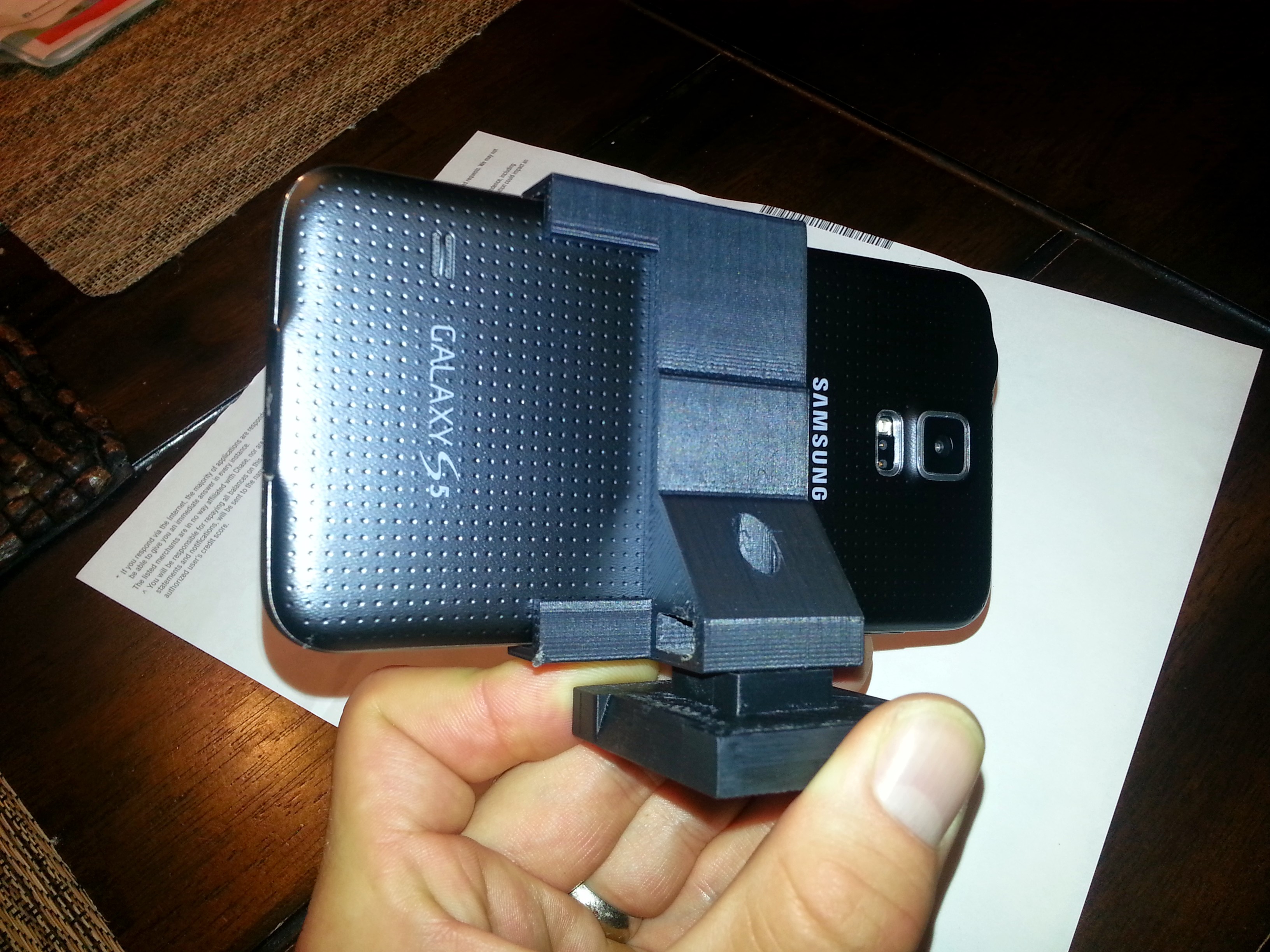

Originally shared by james wolf Took some pictures of my 3D Printed Galaxy S5
Took some pictures of my 3D Printed Galaxy S5 Tripod Mount. The mount has a slot for a standard nut that fits the 1/4 inch threadings on a camera post, so that it will work on any tripod (or anything that mounts a camera).
I designed it in a way that prints easily (i.e. no overhangs) with the layers running 90 degrees from the flex for maximum strength. The phone easily clicks into a secure position, but can be popped out by pressing on the top grip to release the flex.
The S5 takes amazing pictures and I like to use it for my YouTube videos because it posts easily to the web. The tripod allows me to have a stable platform and set the best angle for my pictures and videos.
Designed in SketchUp and 3D printed on my Up Plus 2
Leave a comment if you want the SKP design file or the STL.
