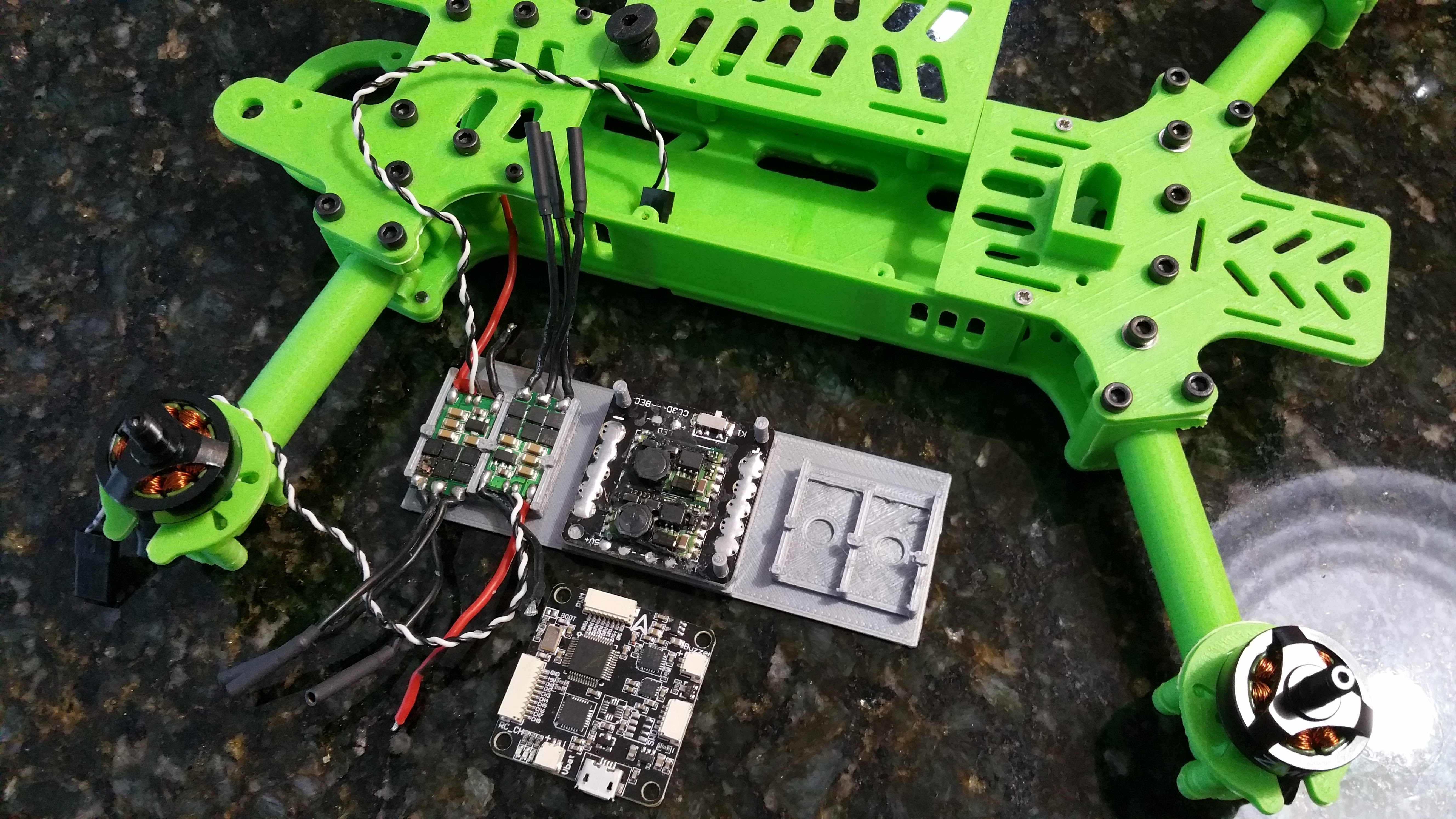

Originally shared by John Car Just finished designing and printing the Electronic module.
Just finished designing and printing the Electronic module. PDB and FCU sandwich together. DYS 16 or 20 amp ESC’s snap into printed brackets. All I have to do now is design the bracket for the 200mw video transmitter and Fry sky transmitter. The whole assembly can be removed with 2 screws.

Loving your work @John_Car . That’s gonna be a real neat build. I soooo want to print my own Vortex and RcExplorer inspired Tri frames but my first printer is a TinyBoy so 8x8x8cm is my limit :frowning: Guess I’m stuck with printing small components until I graduate to a bigger printer.
I have a printrbot metal simple with a heated bed and I had to split the lower frame in half in order to print, then use ABS slurry to bond it back together.
I’d never have guessed … I can’t see the join!
You can go on thingverse and download the files. Tuffest part is getting all the electronics to fit. I might scale this quad bigger to fit a eagle tree vector FCU in the future.
Yes, I noticed the Thingiverse files a few days ago. As you say, it’s a tight fit without the custom ImmersionRC components, so scaling to a 310/330mm size would help. Think I’ll finish my Armattan Tilt-R first … it’s like a bulletproof Vortex on 6-7" props anyway :wink:
