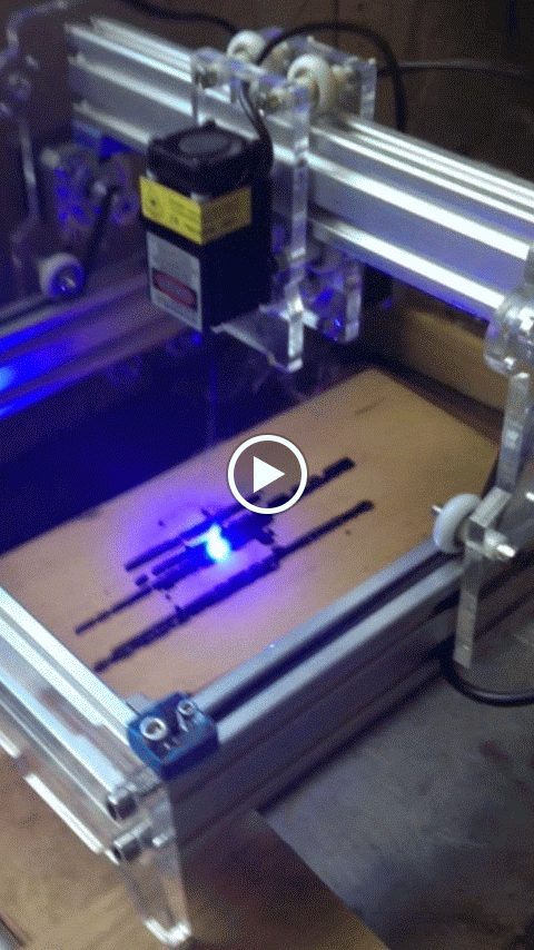

I don’t if anyone can help me out here but I can’t seem to get the darn laser engraving machine working with the included BenBox software! On top of that the stepper motor does not want to for some reason.

@Jonathan_Davis_Leo_L Its really difficult to tell what problem you are having with no description of the issue, and your video doesnt show anything. For all I can tell, it is working properly in your video. I haev dealt with several of these type of machines. If you explain your issue a little better, and explain what is supposed to be going on in the video, I may be able to help.
@Eric_Flynn well for starters the x-axis should be moving and like in the video and so far I can only get it to do just lines and not like the actual image. Like is supposed to do!
Does the X motor make a “grinding” sound?
@Eric_Flynn No, it doesn’t do that at all since its practically a brand new machine.
It has nothing to do with it being a brand new machine. If steppers are hooked up incorrectly they will not move properly, and make a grinding sound.
It appears to be moving some in the video. I suspect the microstepping setting on the controller is set incorrectly
