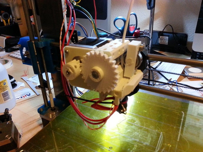

Extruder: The E3D hotend seem to work fine. :slight_smile: But the extruder gives some headache. As @Shane_Graber mentioned the direkt drive extruder won’t work with nema 17 stepper and 3mm filament. Which extruder would YOU prefere?
Thank for any advice :slight_smile:
Try Shane’s compact extruder with MK7 drive gear. It works like a charm.
Yes, that’s on my todo list :slight_smile:

@Miguel_Sanchez Today I assembled the compact extruder and the tests were good. Tomorrow I’m going to mount it onto the x-carriage. Unfortuneatly my stepper is to long so I will have to add extra spacers.
@enhydra Longer than 48mm tall?
