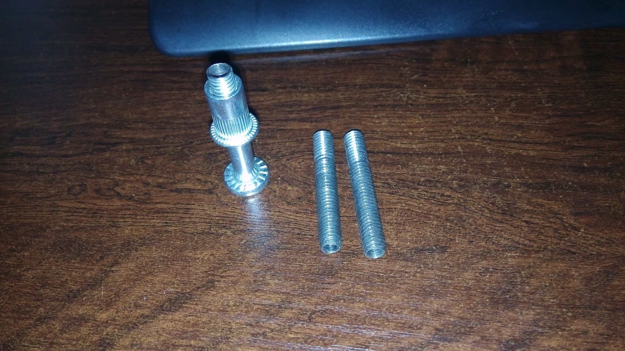

Originally shared by Lee JinHao Diy  ..eh..............but I don't know what you guys call
Diy …eh…but I don’t know what you guys call it in English …I’m not good at English …:slight_smile:
Hot end or nozzle is the term I believe you’re looking for.
@Lee_JinHao That’s the heatbreak, amazing work!
@Justin_Nesselrotte Both of those words sound kind of dirty if you think about it.
A better way to drill those is you put the drill bit in the vice, and the screw or workpiece in the chuck.
@Stephanie_A :slight_smile: thx … if i have a lathe,I think it will be much easier…
@Shaun_Orwell
@Alex_Lee thanks ! my friend!
@Justin_Nesselrotte thx !!
I have used a drill press to make a nozzle. You need cobalt drill bits and lots of lubrication to drill stainless. For the nozzle I used carbide pcb drill bit. All of it is easy to do on a drill press if you set it up right.
@Stephanie_A Thanks for your sharing ,you are really professional! :slight_smile:
