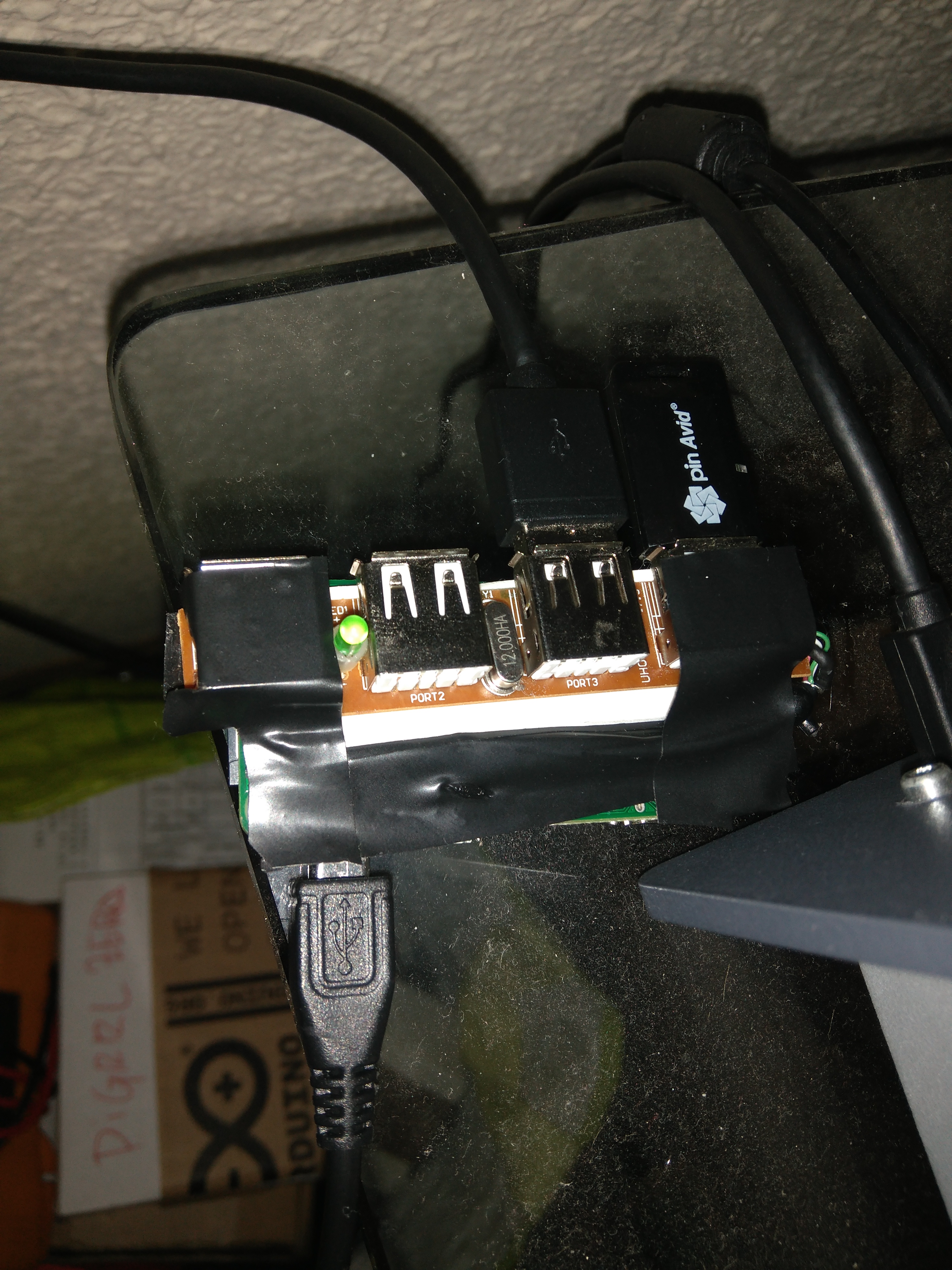

Originally shared by Luis Diaz
It’s been a hacking afternoon! Just added a 4 usb hub to the pi zero and i got running a @OctoPrint server to run my hephestos2 from @BQ111
Looks like what @Griffin_Paquette was working on. Cool.
Couldn’t get my hub to work with it unfortunately. Did yours end up working?
@Griffin_Paquette yes, it is working
I’ve tested before soldering and works great. After soldering one cable I solder one tiny wire of the green wire on pp23 to the shielding pad of the usb, so it didn’t work. Removed that tiny wire and everything is working now.
EDIT: after rebooting sometimes I need to plug and unplug the wifi dongle to make it work (I don’t know why this is happening yet)

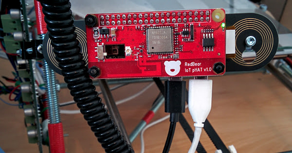

I used this
https://redbear.cc/product/iot-phat.html
IoT pHAT for Raspberry Pi - Product - RedBear
Works like a charm. No drivers or dongles required. The printer is connected to the USB on the zero.
@Dushyant_Ahuja I’ve been doing the same for a few weeks and can confirm its working fine, it seems to be a much nicer/more compact solution than having WiFi dongles and cables sticking out everywhere (Previously I tried a Zero4U USB Hub).
I even managed to find a micro USB to mini USB cable so I don’t need a shim adaptor for the cable.
