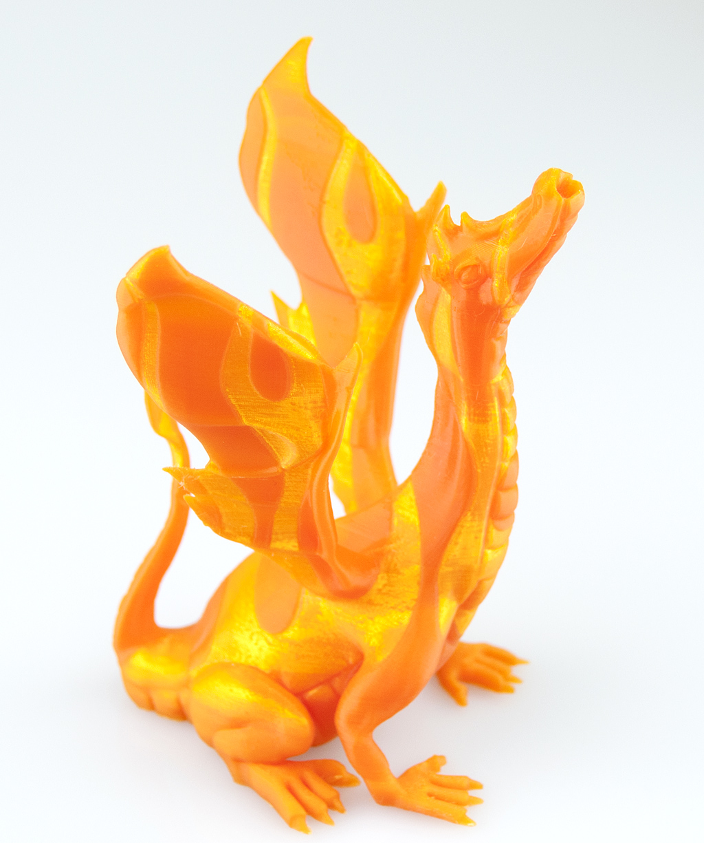

This is @Louise_Driggers 's fabulous “Adalinda: The Singing Serpent” from thingiverse, printed at its default size (about 15cm / 6" high) in @Faberdashery_Ltd 's Orange Fizz PLA using #VelocityPainting.
VelocityPainting (yes, I made term up :slight_smile: is varying the print speed (but not the temperature) to map a pattern or image onto the model – I’m using a perl script to post-process the GCODE from Simplify3D to chop up the vectors where necessary and then mess with the extruder feed rate.
Note: I’ve lit this well to show off the affect – it’s subtler in flat light, but still rather beautiful.
Interestingly, the flames (so the shinier, lighter orange areas caused by printing slowly) are noticeably thinner-walled – i.e. you can easily feel them as an indentation.
210C and a mixture of 10mm/s and 35mm/s. 11.5 hours of printing on my @Think3dPrint3d Kossel Mini.
Result!
#3DPrinting

Low speed produces a thinner wall - would not have expected that…
@Alex_Wiebe yeah, I don’t get that either. And to compensate, couldn’t you increase the feed rate when it’s printing more slowly?

@Mark_Hindess @Nate_T @Alex_Wiebe and others. My Mistake – fast -> thinner, which makes more sense! The fast parts are the lighter, more iridescent parts of the pattern. Here’s the mapping of speed to pattern
I was so expecting the saturated orange parts to be the slow parts that I got the sense of the speed wrong. It turns out that saturated more matte parts are those printed at low speed.
FWIW that pattern is running through the infill as well – like letters through a stick of Blackpool rock.

How much do you adjust the extrusion to make up for the speed?
@_x111 That wood be neat. My script isn’t sophisticated enough to map the scales like that but it certainly could map different images or patterns to different perimeters, which could look cool. I don’t adjust the extrusion to match the speed but speed shouldn’t really change the amount of filament that needs to be extruded between any two points?

@_x111 The interesting affect of projecting the image through the model rather than wrapping it round is that when you view the image face-on it looks flat and undistorted even though it’s on a curved surface. So it can be a neat effect.
