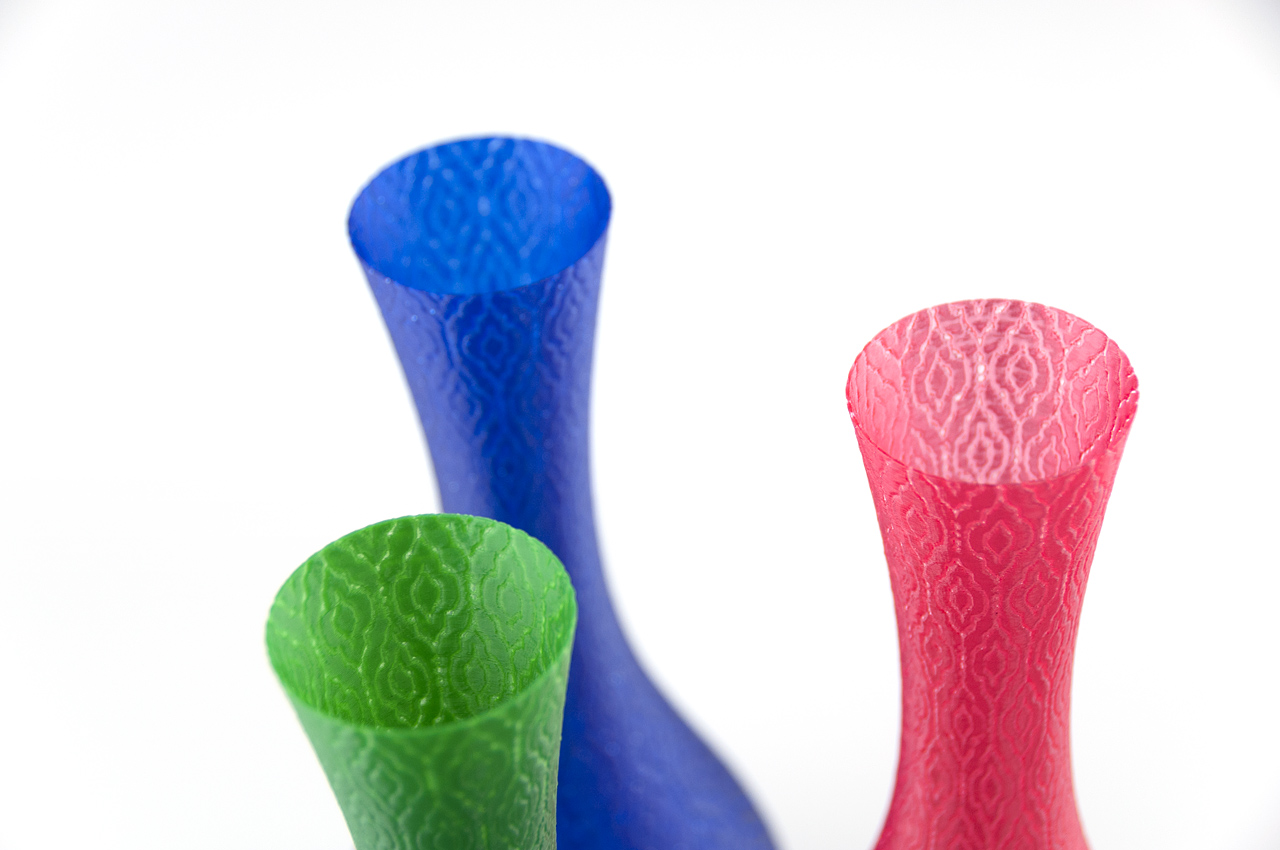

Originally shared by Mark Wheadon Moorish lacework vases Velocity Painting These vases have come
Velocity Painting #VelocityPainting
These vases have come out great. Pushing the high speed parts of the print on a single-walled vase print really emphasises the patterns and these vases look like pieces of art. Think 3D-printed lacework.
You might want to look at the images in the large.
The pink one is translucent PLA (from M3D), the other two are Faberdashery opaques. The vase is my own design.
The (I presume) pressure effects that cause under-extrusion on the fast parts and over extrusion on the slow parts are what this is all about. Put one of these vases to your lips and you can breath easily – definitely for dried arrangements only.
But the look. Oh My :slight_smile:
210C for the M3D translucent pink, 220C for the Faberdashery opaques. 12mm/s low velocity, 50mm/s high velocity, 0.5mm single perimeter, 200mm high, just over two hours print time. #3Dprinting
Stunning! !! Beautiful work!
@Matthew_Del_Rosso Thank you. They look good in the photos but they actually look better in the flesh. They gleam more.
