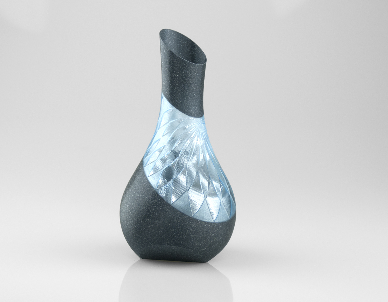

Originally shared by Mark Wheadon My latest exploration of Velocity Painting.
My latest exploration of Velocity Painting. This is an own-design vase printed in @Fillamentum1 Vertigo Grey and Crystal Clear Iceland Blue on my single extruder @Think3dPrint3d Kossel Mini.
Onto that I’ve ‘painted’ a harlequin pattern mapped in a cylinder around the Z axis. The print is spiral-printed with a single 0.8mm perimeter. First person to figure out how I got it to look quite so funky gets a thumbs-up :smiley:
6mm/s slow and 24mm/s fast printing, about 18cm high, 220C, Simplify3D, two filament swaps, wobbly perl script.
Github for the script: GitHub - MarkWheadon/velocity-painting: #VelocityPainting: patterning 3D prints by modulating the print speed
#3Dprinting #VelocityPainting

Funky, printed it angled on the build plate? \

I don’t get how you printed this with just two filament swaps. Oh… not only it’s printed standing under an angle, it’s also printed standing on its top, isn’t it? Amazing!
EDIT: nope, it wouldn’t work standing on its top, it’s more than 45 degrees…
@Jeremiah_Coley Got it in one! Here’s your thumb’s up: :+1::blush:
@Petr_Stehlik It’s printed at a (fairly steep) angle. Here’s what the base looks like, and the facet that was on the print bed is the one that’s on the bottom in this image…
