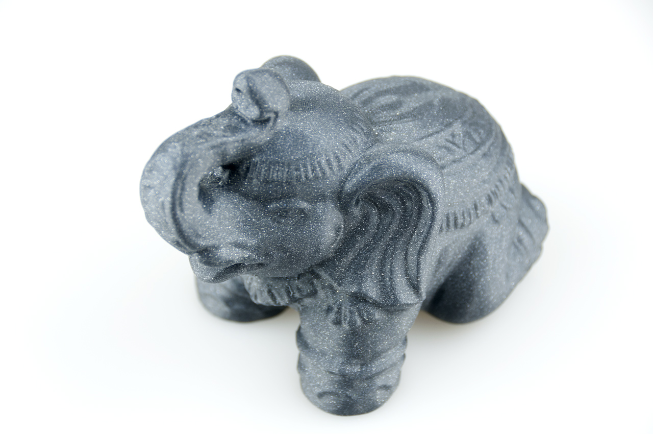

Originally shared by Mark Wheadon No fancy techniques with this one but a lovely
No fancy techniques with this one but a lovely print. There are all kinds of great models available at http://myminifactory.com’s Scan the World. Many of the pictures are awful, but often the models are pretty fine.
This is a sculpture, possibly of Hindu origin, that is now part of our home decor. Printed at 0.12mm layer height on my Kossel Mini in @Fillamentum1 Vertigo Grey. 105cm high, a 13 hour print.
The model’s here: https://www.myminifactory.com/object/elephant-in-oakland-california-4004
Thanks to YouTube’s 3DMakerNoob for making me aware of Scan the World.
Does the filament have little specks in it? Or did you paint the print?
@Mark_Wheadon ​ what nozzle diameter did you use?
@Geoffrey_Forest Yes, it’s subtle but looks great.
@Alex_Krause 0.4mm
@Geoffrey_Forest when I say yes I mean yes it has flecks of glitter in it.
@Mark_Wheadon wow, where are your layer lines?!?!
@Geoffrey_Forest When you have an image with, say, banding in it (perhaps because you have limited levels of grey and an area ramps smoothly from one grey tone to another for example), a great technique for effectively removing those artefacts is to add some noise (film grain in Photoshop for example) – stops the eye following the lines. I think the flecks in the filament are doing the same job.
So the layer lines are already faint because it has 0.12mm layers, but the flecks of glitter effectively get rid of what’s left. Result!
Why .12 mm layer? As oppose to .1 or .15
@Step_Cia So far as I know there’s nothing special about 0.1 or 0.15? I wanted it finer than 0.15, but I’m not convinced I can see the difference much beyond that, so picked 0.12. Diminishing returns of quality vs print time ‘n’ all that.
Really liking the look of that filament. Awesome print.
