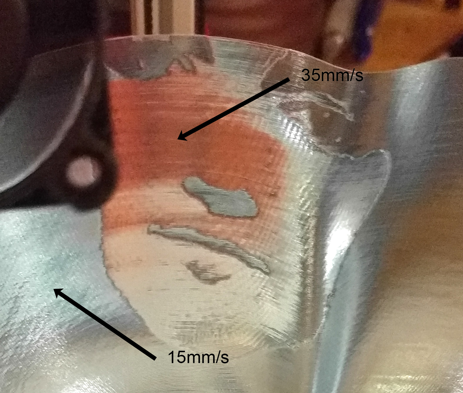

Originally shared by Mark Wheadon
Very different effects with different PLAs.
M3D PLA → fast is glossy + more translucent
@Faberdashery_Ltd PLA → fast is matte + opaque.
Image below is M3D translucent PLA.
#3DPrinting #VelocityPainting
Do the fast sections seem under-extruded / have narrower extrusion width or is the surface still flat?
@Mark_Hindess Good question. They shouldn’t be as exactly the same amount of filament is being extruded but I guess the bead may be a different shape. I’ll have a go at measuring it this evening.
@Mark_Hindess I don’t think so, but I’m less than sure. The prints I have are curved at least a little in all three axes so are not ideal for measuring without a fair degree of error. When I have a flat print using this technique I’ll have another measure.
